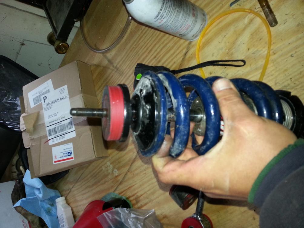

Good question. I've had to slow production until I get a new way to cut the washers (the parting tool for my lathe broke) and then I've got to find a source for more 4340 since my regular supplier is out. I could be ready as early as next week to do another set of them, but I only have enough 4340 for one more set.
On a positive note, I have plenty of polyurethane. This is a really good thing because this stuff is hard to find in the 95a hardness.
A couple days ago I shipped my second set off to Bomba02 that should be arriving for him tomorrow - but they're for stock upper mounts. Once I have a better method to cut the 4340 I'll need to check my notes and confirm the dimensions with Atomic before I make a set for use with his uppers.
