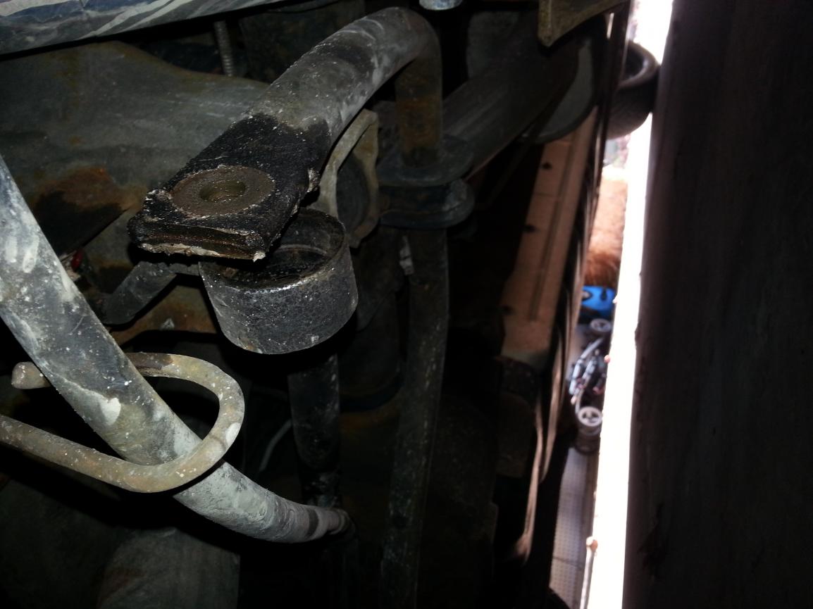

Well guys, I *THINK* I found the problem that was causing my rear sway... looks like I need new rear sway bar end links
"WELL THERE'S YOUR PROBLEM" :) Seriously, glad you found that. That may not be *the* problem, but it's definitely something that you needed to find.
I knew it had to do with the sway bar area. lol. Glad you found the problem and got a pm coming your way.

I seriously can't imagine how this happened. When I say they weren't very tight, I mean by my standards, and ive been known to twist bolt heads off with normal 1/2" drive ratchets, so its not like they were super loose... only thing I can think is when I swapped out bolt hardware to "get rid of the slop" maybe I forgot to tighten that one, but still crazy the whole bushing came out too. I found this when I got under the truck to change the oil tonight, and was like hmmmm something looks weird back there...

that will happen when bolt comes out. The sleeve falls out and bushing just twists and twists and falls out
