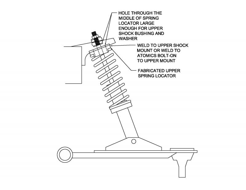

So I have a silly question. Why couldn't someone machine a spring locator out of mild steel (or buy them?) and then weld it to a bolt-in bracket like the ones Atomic makes? That would eliminate the weight of the Tahoe being on the shock itself and then you could just use a stock style poly mount for the upper shock/coil over without the worry of the weight crushing the poly? Very similar to how an older muscle car would still use the stock upper spring perch for a coil over setup. Like the drawing I made below.....
Will the 2.5" spring physically fit inside the upper Tahoe shock mount or is it too big?

Well thats interesting....to partly answer why not, I just wanted to use bolt on parts, and once I got mine working I was done with R&D lol.

M hankel could possibly be a genius!
howabout this... if that will actually work, would you even NEED a spring cup, or could you just push the coil up into the stock perch? that is, of course, assuming that it would even fit up there

The spring must be supported evenly otherwise the loading gets all weird which a coil spring cannot handle. At minimum you need a cup to evenly distribute the load.

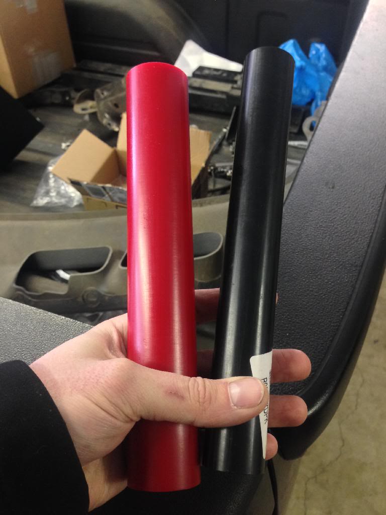

now, about those williams washers you linked earlier... what size do you think i would need? im gonna order a few tonight and that polyurethane off ebay too and see if i cant make something happen with the stud top

Slightly larger OD than the poly you bought...but I think the guy in the PT thread tried poly and it didnt stand a chance. I think his current one that is working is derlin.

in his pic of the two, his poly was red and the delrin was black...
looked to me like the problem was that the bushings would deform under load and get fatter and eventually smash around the washer... if the hardened steel washer was fat enough, i wouldnt THINK the poly would be able to squeeze around it

So... May be a stupid question but do you need a bushing there? If so what other material options are there? Surely there is something that can handle the weight...

You are a genius hankel, it would be like a camber plate but stationary. Thats how coil overs or struts are held in the shock towers and still have the poly mount in older cars or sports car. Think your onto something!

I agree with you, but over on PT with atomic included they mention you need some pivot to avoid binding. blah blah.....haha so i think you need a material that can with stand the weight but flex....feel me lol

Can you run a dual "hoop" mount like the lower, but up top too and atomic can remake his mount to with brackets and a hole in each kinda like the lower one. That would allow pivot. And if the bottom holds then the top would too. Something like this http://www.qa1.net/qa1_motorsports/...ts/custom-mount-shocks/single-adjustable.html
Now I know nothing about this, just throwing out ideas. I don't see anything about weight limits on their website...
Edit: nevermind I'm an idiot lol.

My only issue with the stud top is that it looks to me like he smashed both the top and bottom bushing between TWO pieces of metal... would you want the poly bushings to only be separated by the metal of the shock mount?
I guess if I had to describe it it looked like from top to bottom was... steel washer, poly bushing, steel washer, shock perch, steel washer, poly bushing, steel washer
I would think you wouldnt want the steel on steel on steel at the perch... or did I see that wrong?

I dont think the bushing on top is doing anything for him. You need washers on both sides of the lower bushing so it gets compressed evenly.

Ok, so the top isnt even a problem... the real issue is just the lower bushing getting crushed?
So i would want the 2 pieces of hardened steel to be on either side of the lower bushing... then the top really wouldnt make much difference right?

Right....a bushing on top would only do anything if you were applying force in that direction...which means the shock would be overextended and you would have a whole different set of issues to deal with.
