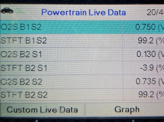

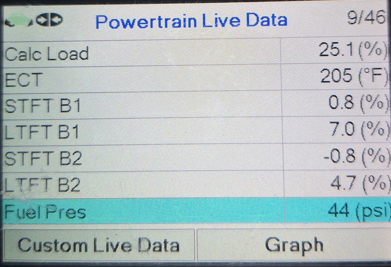

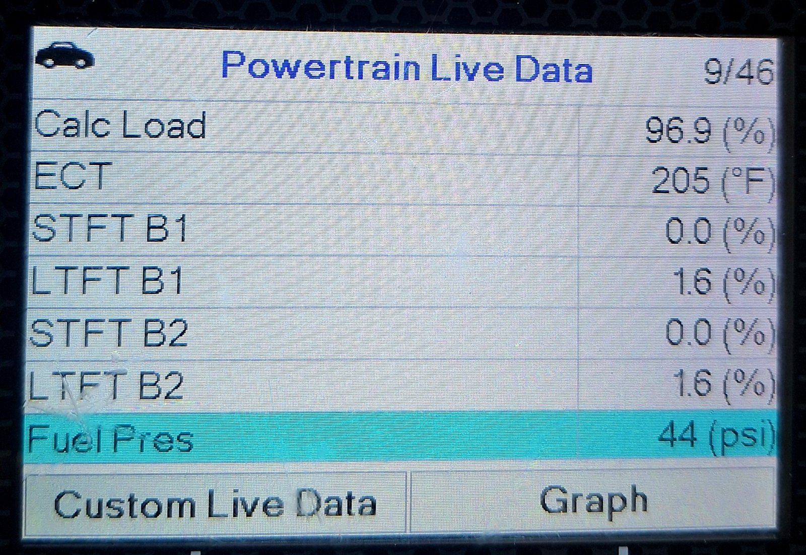

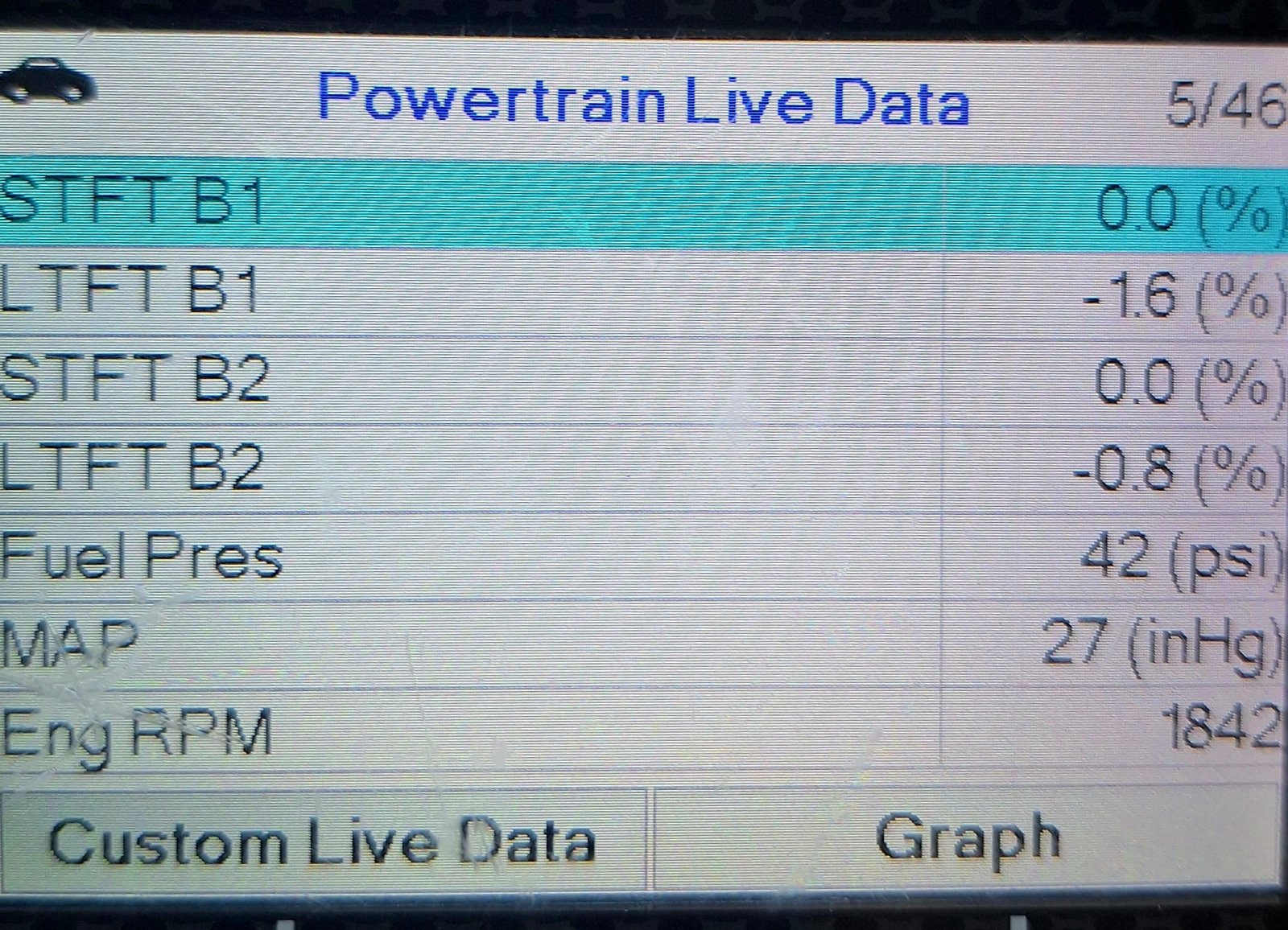

These are some photos of the fuel trims

You can test the pressure, if it drops off more than 1-2 psi at WOT it's no good. You test the FPCM by doing an ohms test.

How is your fuel pressure when you are driving around and at WOT? Does it drop below 42 psi?

Fuel pressure looks pretty good so far over 42 psi.
