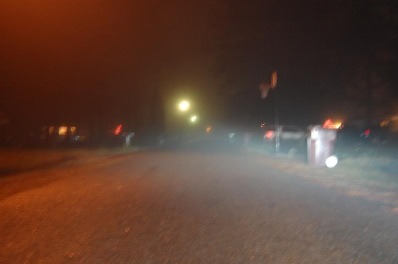

Again, everyone has their own opinion but no where did this thread ask what color lights do you like. It was started to inform a member about HID's. If you don't like the color of the lights, fine, but I also don't remember anyone asking for your opinion either!

It's kinda hard to see any kind of light pattern in dense fog and under a street light regardless of who's vehicle it's on. He asked to see the color of the bulb. I was being helpful to show him. I never asked for anyone's opinion on what they thought about my vehicle. If you don't like it, fine. I don't expect you to. I didn't come on this forum to cause trouble, I came here to be helpful. I haven't seen anyone else showing him bulb colors and I don't see you telling him the RIGHT choice.
