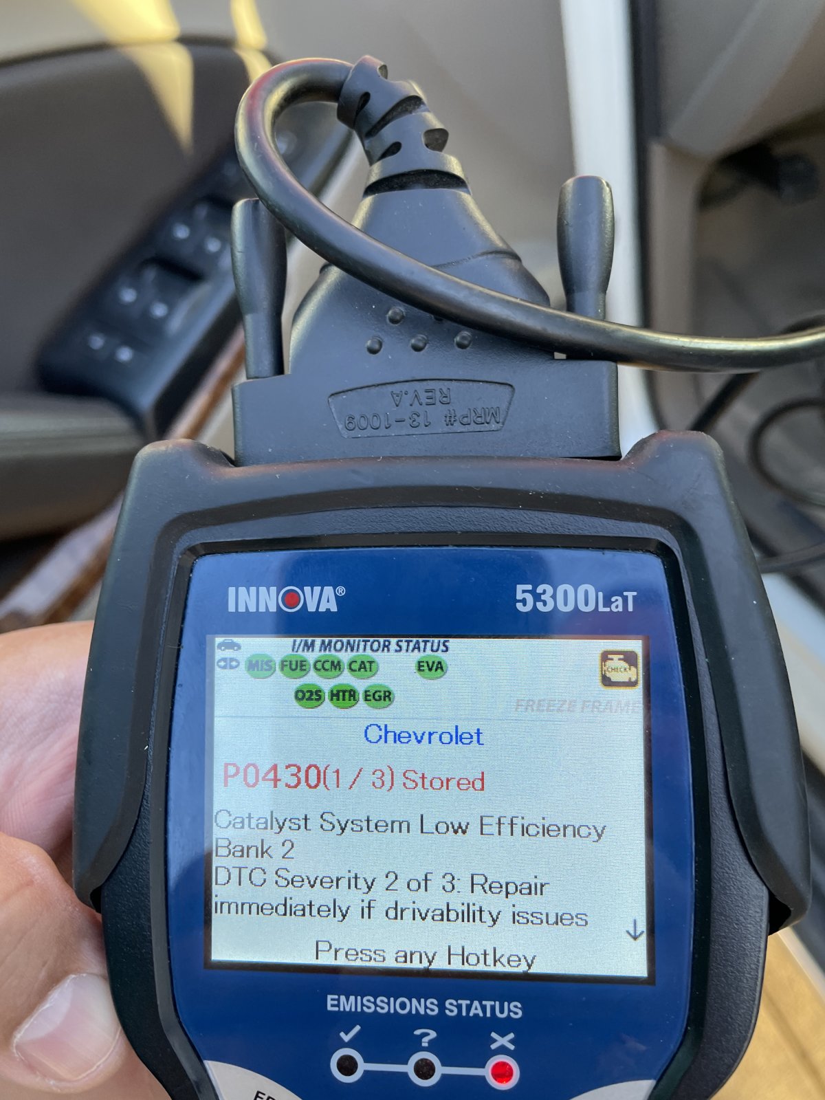

I am intermittently getting the codes/messages noted above. I've already replaced the O2 sensor on the right side as noted (I know there's two of them), but I'm wondering if anyone's had experience with both of these popping up on your vehicle and a solution for it? Gas cap is always tight and it doesn't matter where the gas was bought from, how full the tank is, etc.
Never seems to effect the way it's running, idling, etc.
If there's a test that can be done, please post a link/details to it. My nephew is a tech for Mercedes and can do what I need him to but I need to "feed him" the info (don't get me started...).
Thank you!

Yes, well, "Tighten Gas Cap" isn't a code, you're right about that. One could call it a description of an evap code, no?
Not trying to be a smart ass , but the only reason to check a gas cap would be for an evap code, it would not change the code mentioned. There is no evap code present. The code mentioned is for a catalytic system below efficiency threshold. The picture of the scan tool states one code and says nothing about a gas cap. I get the impression the author said he tightened the gas cap because that is what everyone does when a check engine light comes on just in case. Replacing the cap would be a waste of money in the absence of an evap leak code.
Not trying to be a jerk, either, but it seems like you're picking nits. The OP stated he has multiple codes, he just didn't list them all. He showed one code (of three in the scanner) and wrote another code's description. @Tahoe14 appears to have responding to the code that was described. It's "bigger picture" stuff. Yes, I'm quite done now.

Thanks all. For what it's worth, there's only 1 code that's thrown and the scanner has 3 pages that show/describe the code. The only code is P0430. The DIC will sometimes tell me to tighten gas cap, but there's no code that gets stored. But, for $6, I replaced the gas cap. Now...everyone can take that one off the potential culprit list.
