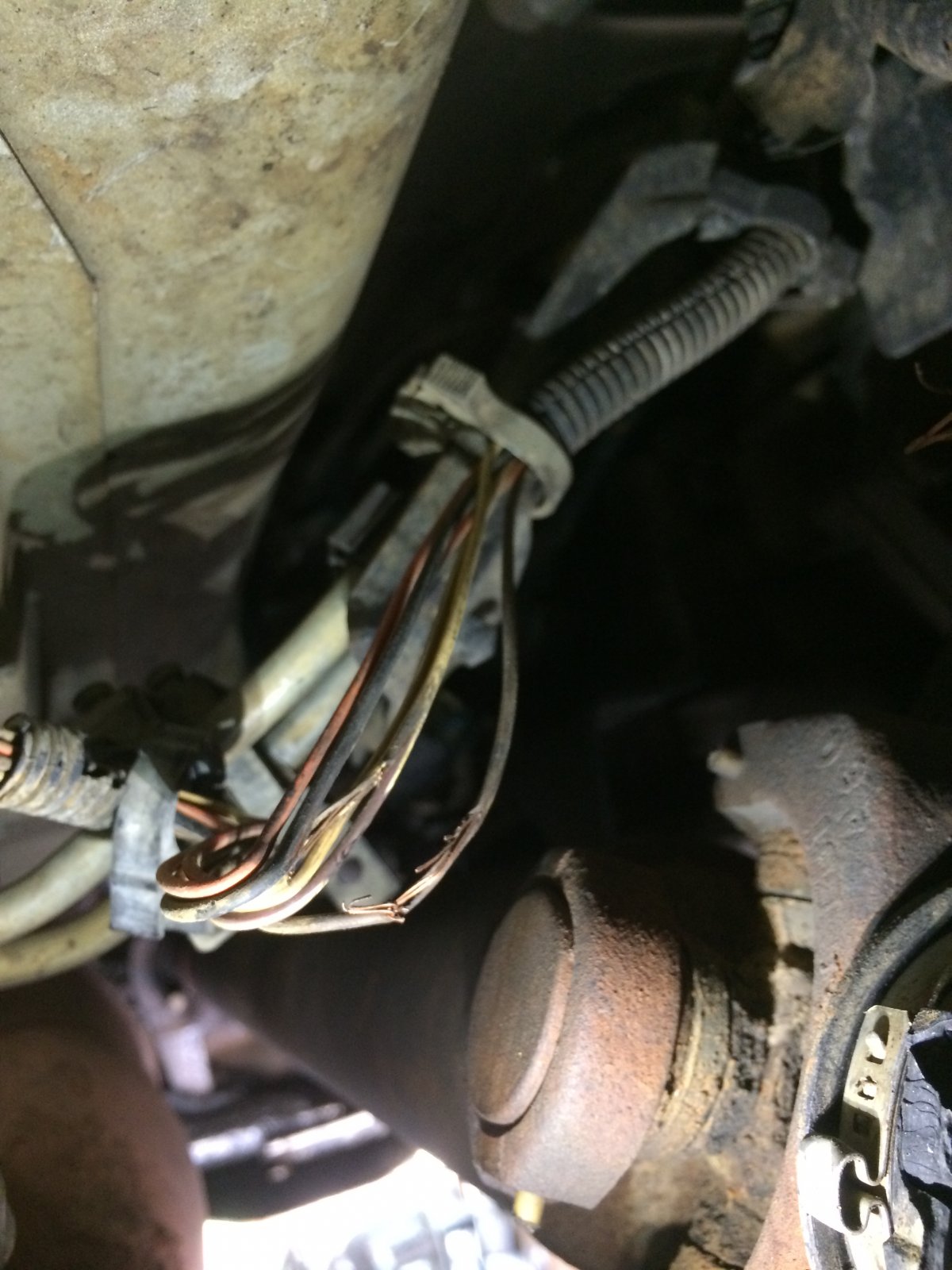

About that 4WD stuff- When inspecting the left rear O2 sensor, I found it's harness had been rubbing on the rear U-joint for the front prop shaft. The copper for the O2 sensor and fuel composition sensor wires were exposed:
I cut, stripped, soldered and heat-shrinked the wires and secured in a safe place. There's a harness and plug hanging nearby that I couldn't find a termination for:
Anyone know where it goes? I have a feeling what I found next might answer this. There's a box that appears to be a controller/actuator assembly on the transfer case with bare copper sticking out of the top as if a plug connector or wire harness was ripped out of it:
Any chance that there was a harness coming out of that upper left side with the male end for that aforementioned rogue harness?

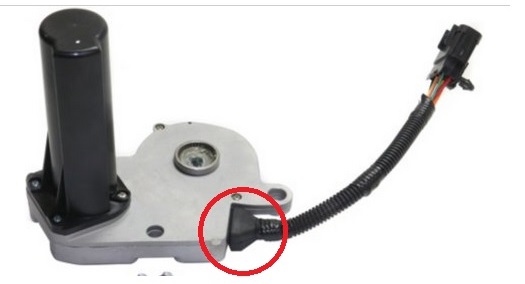

As @Doubeleive indicated, the rectangular connector (female) is the body side of the transfer case encoder motor harness. I've never seen the male pigtails anywhere but can't honestly say that I've looked. I posted the wire colors and pinouts from an AC Delco encoder motor in another thread sometime last week, if that would be helpful. None of the Upulls around me ever have the encoder motors since the engines, trannies, and transfer cases have always "left the building."
45,013
needs a new encoder motor or the harness if you can find that separate, gas cap redesign may have just been for the little tab part that keeps it secured to the filler tube so you don't leave it sitting at the gas station pump, if that is the case easy fix
That's what I needed to see! So, it's called an "encoder motor". Seems easy enough. Would this be a safe part to get from the salvage yard? We're working with an extremely limited budget and he enjoys searching the 'yards for things.

After seeing Wes's post, I was reminded that I found a wire wrapped around the slip yoke of the prop shaft. It must've been a remnant of the harness to that encoder motor. It's probably hard-wired into the part and is a pigtail to connect to the vehicle harness.

I don't think the encoder motor would/should cost you much at a yard. You can get the internal encoder ring and rebuild that part yourself if it's defective, but the motor itself would have to be good. I see rebuilt ones online for $110 to around $300, so they're not cheap. Dorman is the only place I know that you can get a new one.
That was probably the pigtail from the encoder motor. Any chance the connector is good, or even there? If so, maybe I could look at one here to see what the internal connections are.
The connectors have a body attachment above the front propshaft and slightly to the left of the tcase; someone probably didn't re-attach it and it got caught in the propshaft, which is always turning (except when stopped and in tcase neutral, I think).

ya you could get lucky with one at the scrap yard, a new oem one runs about $180

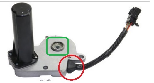

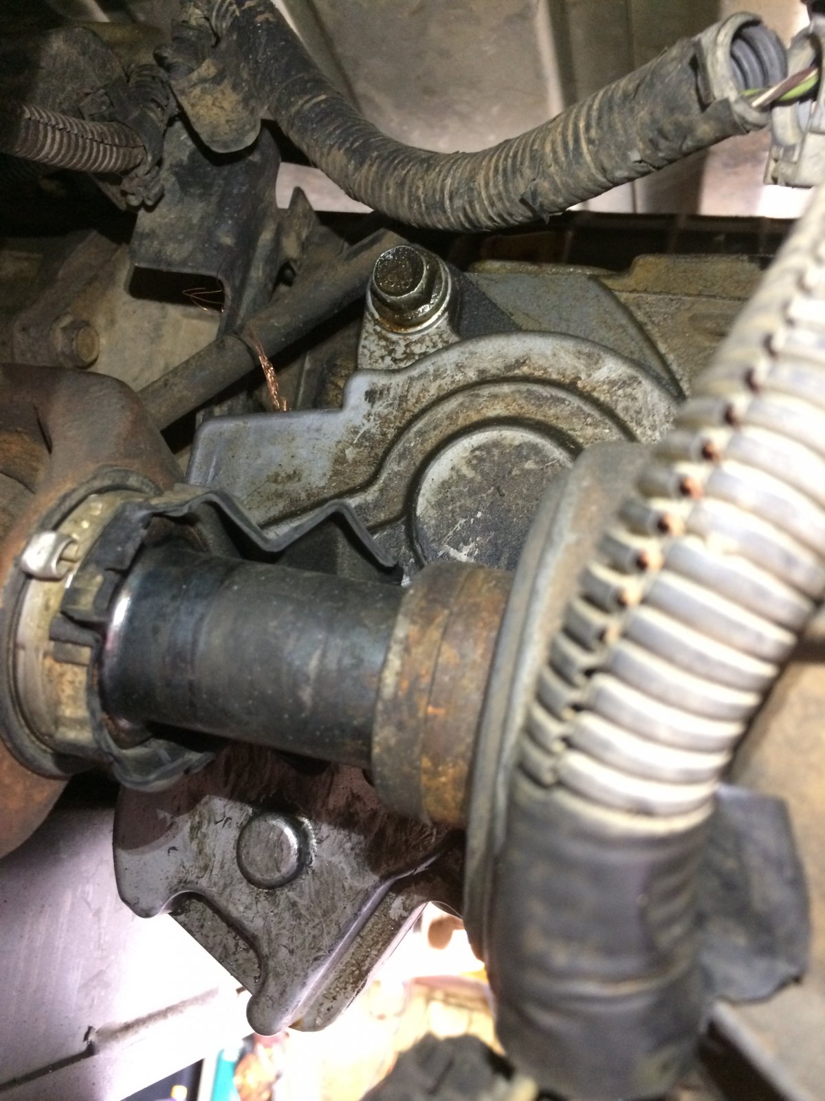

So, there's a short double-ended harness that one end plugs into a socket on the encoder and the other end plugs into that vehicle/body harness?
I felt down inside where the wire was coming out of that top left corner of the encoder but couldn't tell what I was feeling for. I assumed that part was hard-wired with the pigtail coming out with the connector to the body harness. Someone's been in there before and that's exactly what happened- it wasn't properly routed or secured and the wire snagged the U-joint and was reeled in.
Moderator
16,624
34,412
People's Republic of Colorado

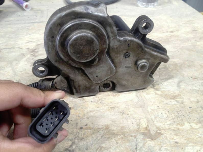

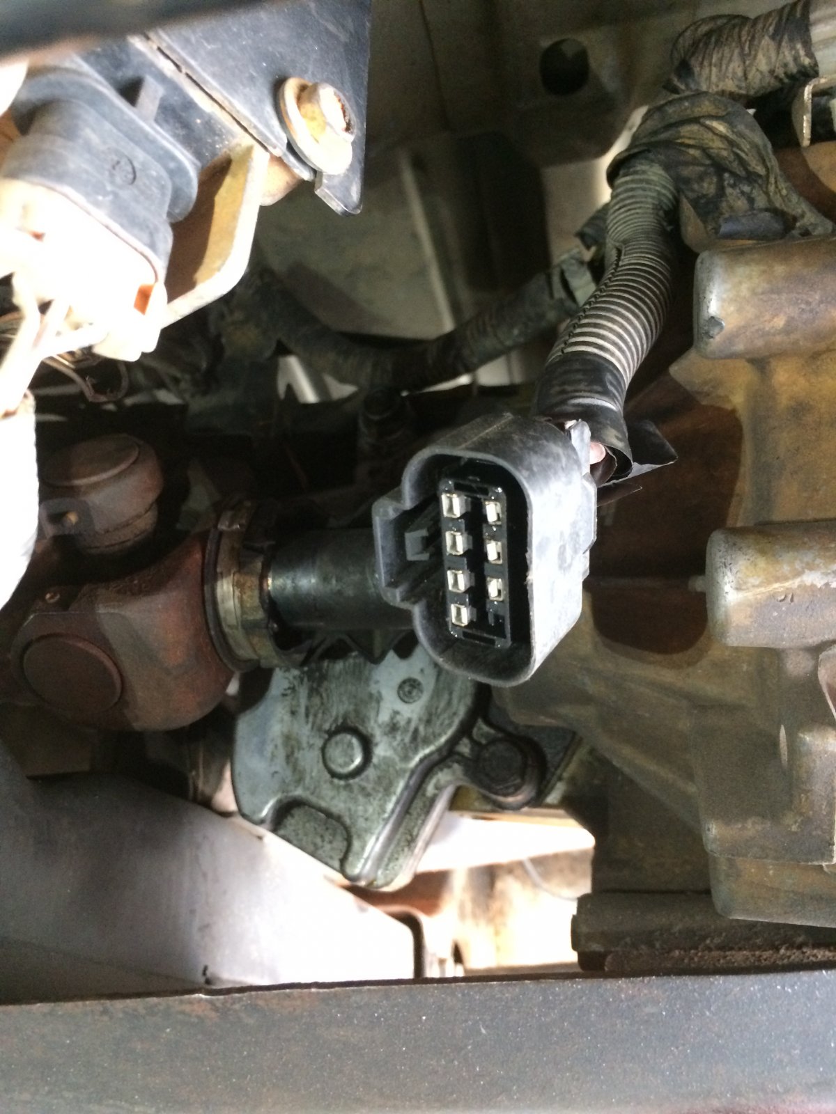

The encoder pigtail is hardwired through a rectangular rubber strain relief. I don't know how the connections are made inside the housing.
Added pic:
I'm sure it worked before because he told me how he realized that, while driving it on the highway back from where he bought it, he had it in 4 HI. He said he put it back in 2WD and by the time he got home, it wouldn't go back into 4WD any more. No lights or anything. I'm thinking the PO had the O2 sensors replaced and they mis-routed the wires, and somewhere along the trip home is when the harness snagged the prop shaft.
If we find an encoder motor from the salvage yard, I'll compare the guts to make sure it looks as good or better than the original. A new one is definitely not in the budget. Really, 4WD isn't even needed and he's focusing his funds elsewhere. This is just one of the items I wasn't so sure about and wanted to be well-prepared for when we hit up the 'yard.
45,013
Pull the encoder motor before going to the junk yard and look at the part that the motor turns (green square in the picture). It'll either be star-shaped or have two flat sides. The older ones have the flats; his is probably the star-shaped style.
