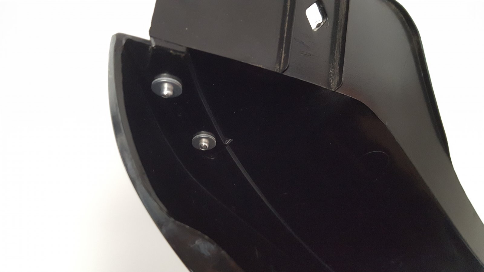

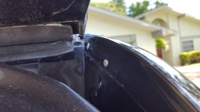

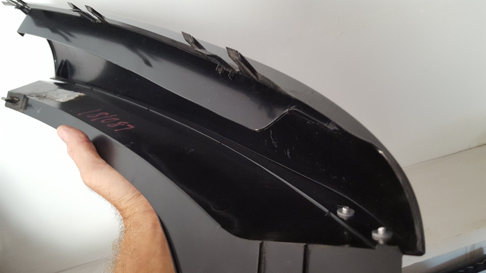

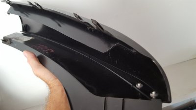

I mentioned this in another thread.... The Esky caps are a glued/ 2-piece assembly.
My used ones are in good condition, but they were separating at the upper portion. ( Maybe due to how you must firmly pull them out to remove them?)
These pics show how I used rivets to make sure they stay attached permanently.
And when caps installed, you see rivets only when glass is lifted on inside. Touch up silver rivets with paint and you'll never see them.
