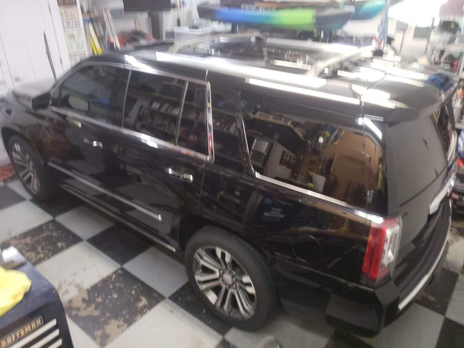

I ceramic coated my 2018 Yukon the other day using CQuartz UK 3.0 which has high ratings with independent testing. A large but still small bottle allowed me to get 2 coats on.
The paint prep/correction is where the cost is. I did a wash, claybar then washed with a striper soap before doing paint correction/buffer then applied 2 coats of ceramic which is the easy part. The whole process took me 10hrs and my paint was in good shape before I started.

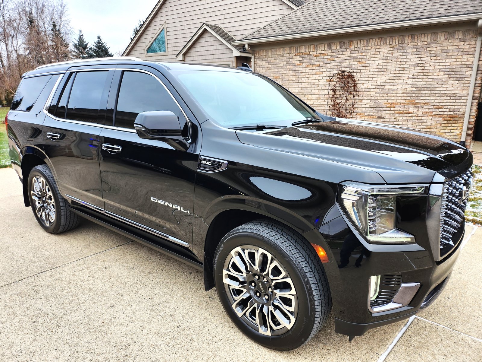

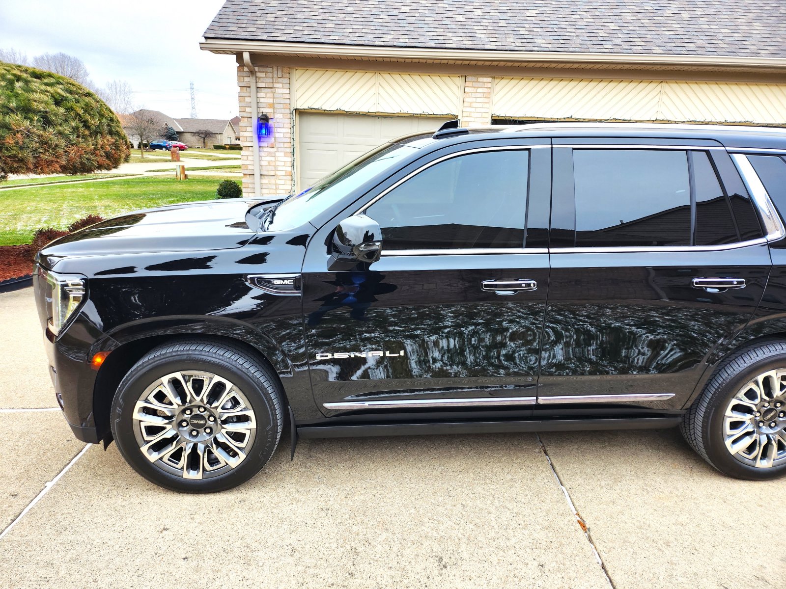

Here is my black Denali Ultimate that was recently finished. The paint correction is the most important part and mine from the factory needed it. Mine was done with 450 miles on the vehicle, the deep gloss black is fantastic now and not a scratch or swirl mark on it,

Seeing I just ceramic coated my Yukon last week I have fresh times. Wash, claybar & full paint correction from top to bottom 7 hours. 2 coats of CQUARTZ UK 3.0 ceramic coating with 1 hour wait between coat then a wipedown with Reload spray took 3 hours. To cure the ceramic coating the Yukon stayed in the garage for 3 days.
The soft towel pieces supplied to apply the coating turned rock hard after a couple of days. So far the rain washes my Yukon clean. I used less than $100 in materials + 10 hours of my time but I enjoy the detailing process.
