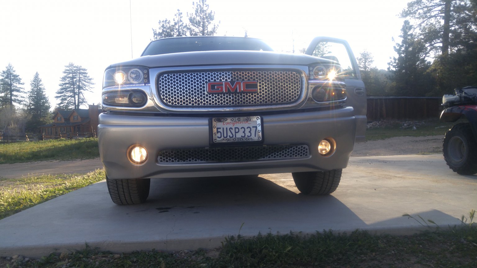

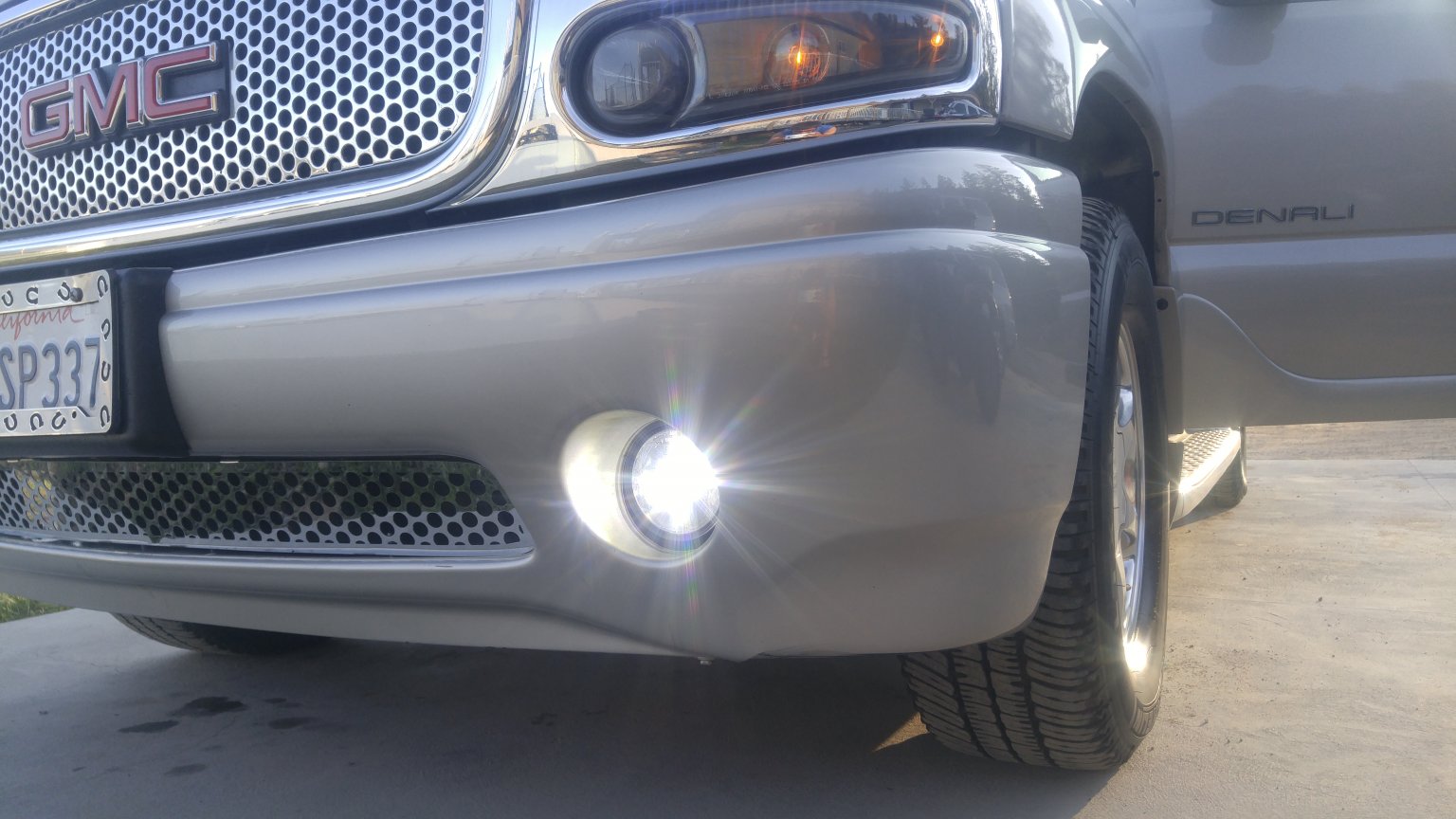

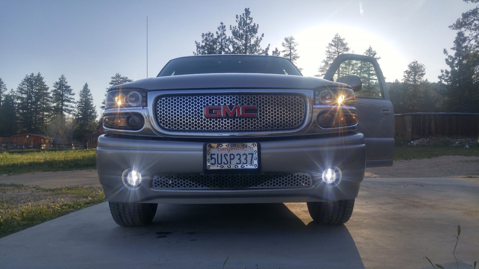

@Kingfish585 , the LEDs around the headlights is an excellent mod. I'm still in the middle of redoing mine. Bought a set that didn't last long through the elements. The new set is cool but I needed to buy the longer version. It's a cool little white tube with the LEDs inside. There's a ton of different options on eBay and they are all pretty cheap and easy to wire in. Also I ordered led fogs from xenondot.com and I'm very pleased with them. They were fairly cheap and direct plug and play bulbs that went into the stock pigtail.

Yeah that lower grill is my pride and joy mod haha. Anyways the way our lights are wired is that the daytime lights will not come on at night. Unless you do a mod and I'm not sure how exactly it's done. I know it's fairly easy though and there's a thread on it. My halos are wired to The day time running lights so they come in when I put my car in gear during the day. And then the night time running lights come on with the headlights so I wired my led strips to that.

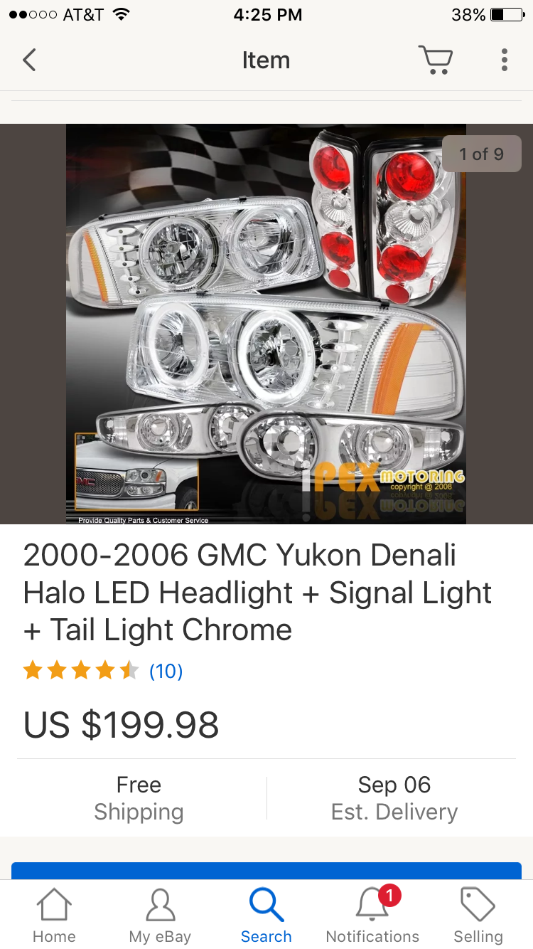

View attachment 65982 I can across this seller on eBay and for what I get, it looks like a lot of the light pairs I see on Amazon and other places for cheaper. With that many reviews it seams like a good deal. Anyone had experience with this seller?
There's several of those same headlight combos on EBay, different configurations as far as chrome w/ clear lens, black/clear, black/ smoke lens etc. Pretty decent projectors, and although some say they are Spyder brand they can't be retrofitted with TRS's Spyder kit. They work well with regular HID though. I would go with LED tails though, those ones look cheesy. If you go with smoke lenses be prepared to do a 55 watt HID or they will be dim. I have some info in my build thread.

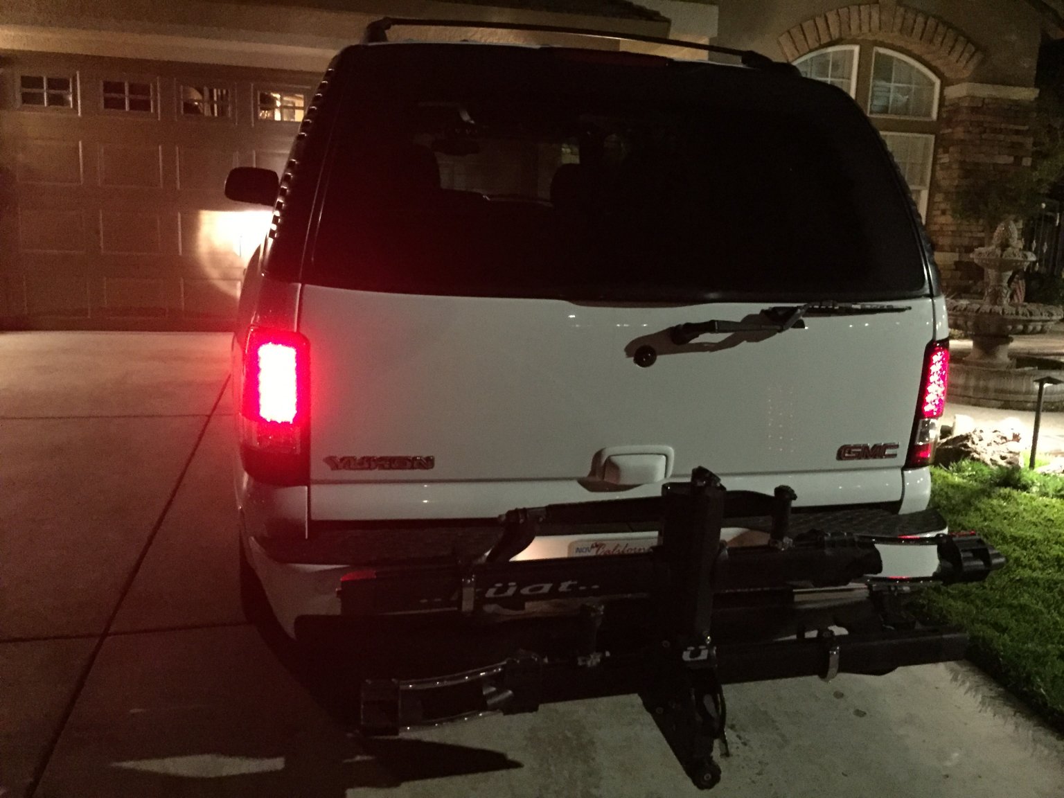

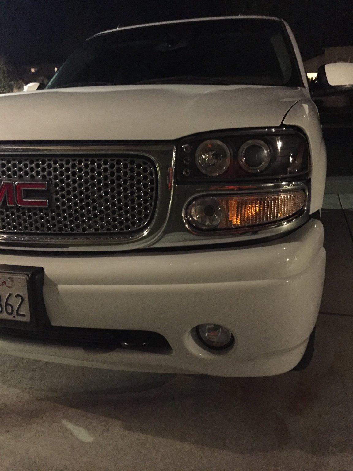

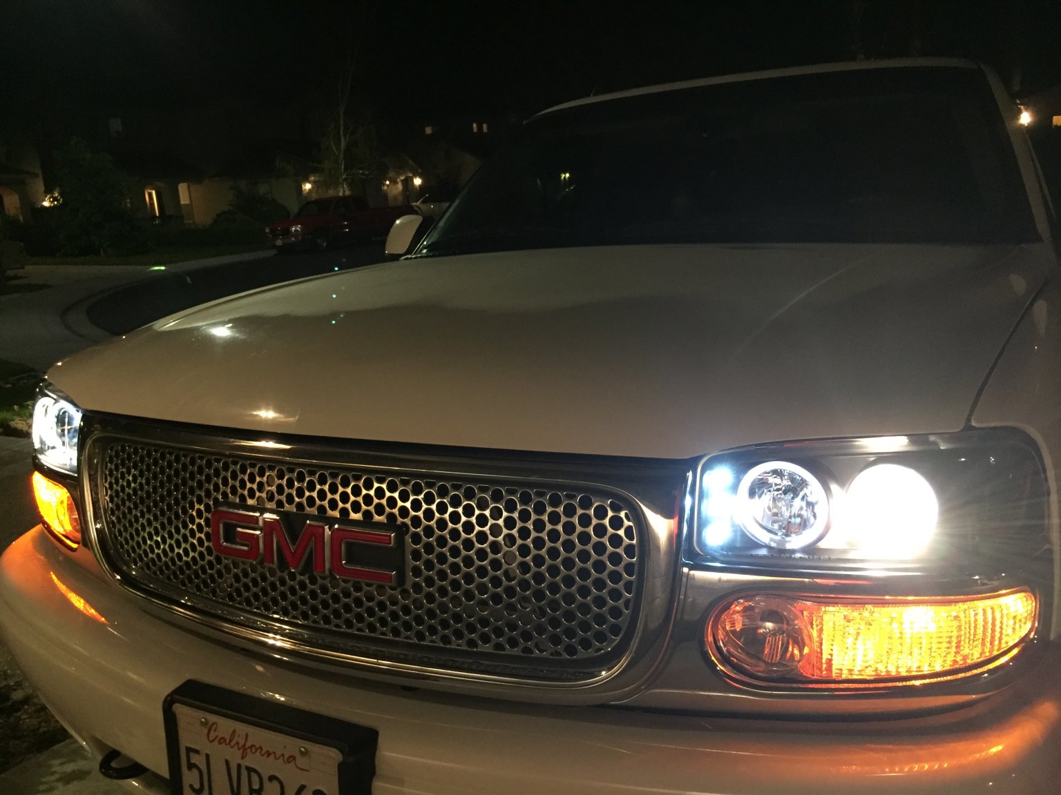

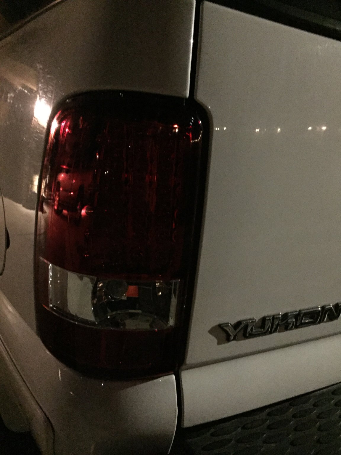

So just got the headlights and they look sweeeeeeet. Taillights were also included and look perfect. One question is which cables to splice into for halo effect power. The headlights or the drl cable? The halos won't work if the drls are on vice versa
52,949
Neither, you want the halos spliced into the park lights. The ones that come on when you turn the headlight switch to the first position, before you turn the actual headlights on.
