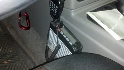

Not a CB, but I installed my Yaesu FT1900 along side the console molding on the drivers side. The face is looking up at you, and I simply ran all the wires under the console molding, ran a hard-line to the wiring under the hood, and the antenna up the side pillar molding and out thru the rear passenger door (I don't have it perm installed on roof, will not fit in garage)
Only thing I have to be concerned of, is spilling my drink, and a short person moving the seat up too far, neither of which are serious concerns as I'm the primary driver. I can snap a photo if you'd like.

Can I see a pic? I'm still leaning towards the cd changer location

I didn't want to rip anything out of the dash, just because I'm pretty **** about that sort of thing. This doesn't interfere with driving at all, and I don't worry that the audio is lost under a seat, in the console etc.

I like that and was thinking the other side. I really don't want to rip up my dash either. I need to find a bracket for the install. Mine did not come with one
