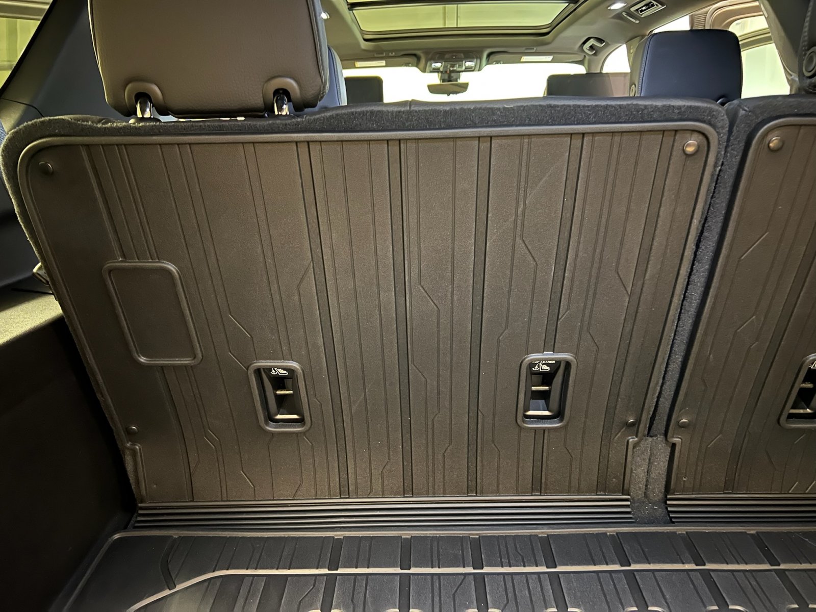

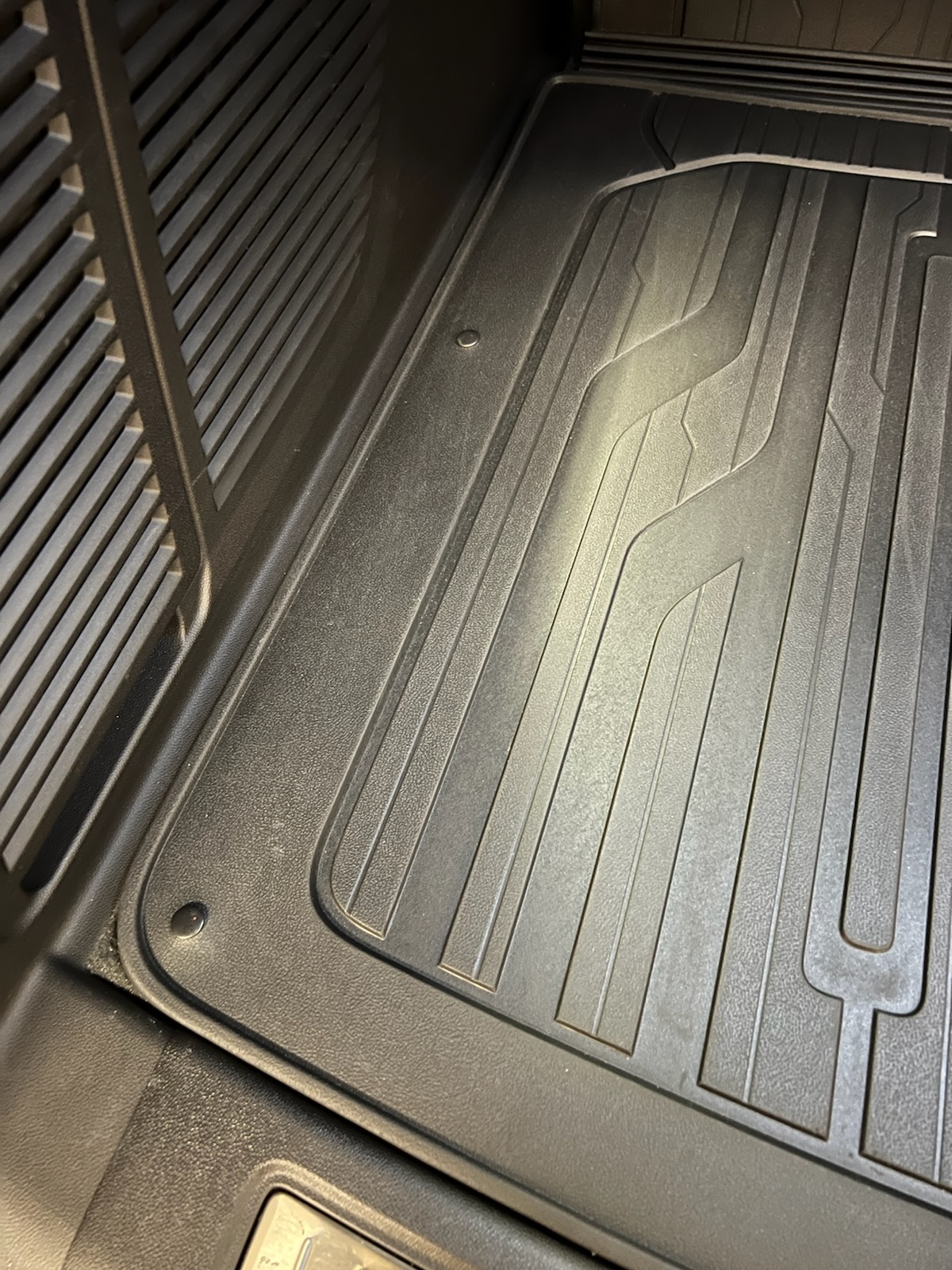

It worked really well. I did make a HUGE mistake with the placement on the passenger side seat back. Have to make sure to keep the snaps high to not interfere with the part that covers that gap between the floor and the seats when it moves. I feel like an idiot now. Four snaps on each mat worked out really well. I removed all the velcro except the OEM pieces at the top of the "60" section on the seat back. They don't move at all, really secure, easy to remove and reinstall.

Looks nice. Are those the gm mats? How was the install of snaps? What kind of snap did you use? I might consider getting the gm ones and doing snaps as well if it isnt terribly hard to do.

Thanks! Yes GM mats. Snaps were 12 bucks for a kit on amazon. Just got stainless snaps made for a boat cover. I did learn a lot along the way. I was trying to punch a hole in the mat while it was in place then see that mark in the carpet. If I could redo the process, I'd install the snaps in the mat in the proper locations then lay the mat in the truck, push down on the snap to make a ring in the carpet and just screw the stud into the middle of the circle. I'm really happy with everything except the holes I made in the wrong spot on the one seat back...

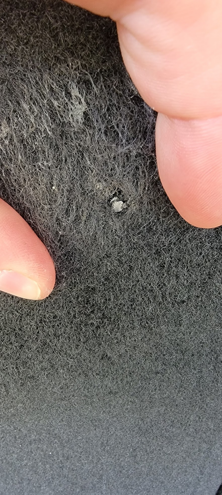

Can you link to the snaps you purchased? The ones i got are SUPER soft. The snap twisted off in the seat back even though i drilled a pilot just a hair smaller in diameter than the threads. Now there is a 1/4" screw stud sticking out and a pretty good hole in the seat back from me trying unsuccessfully to remove it. Not sure what to do now.

Wow, that sucks. I didn't even drill pilot holes. I just screwed them in and had no issues at all. I used all the shorter screws from the kit, didn't try any of the longer ones if that makes a difference.
