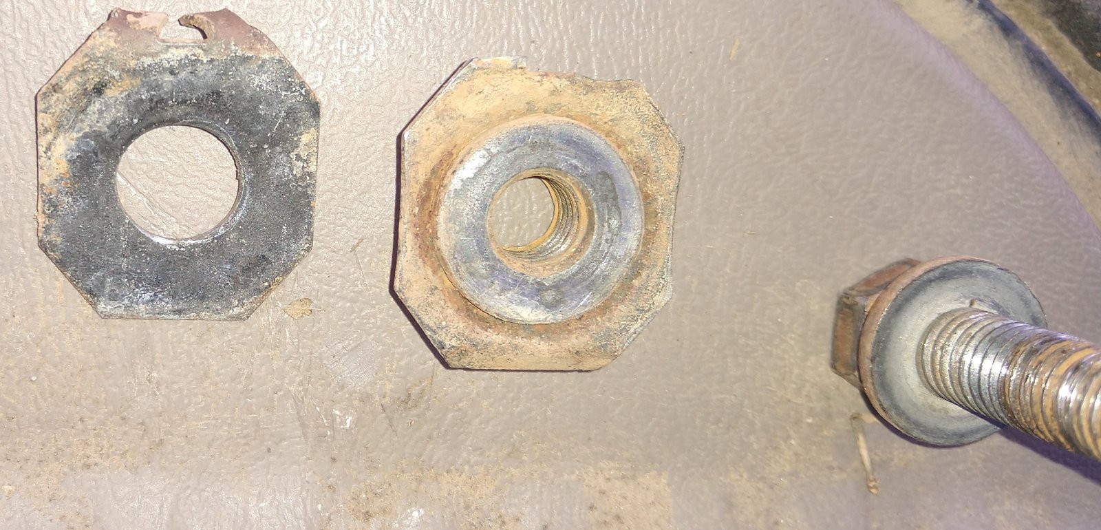

Have a pic of the old j-nut so we can see what went wrong with it?
Doesn't look great but I actually don't think it was rust. The ratchet got set wrong initially so instead of loosening it just got tightened more and more.
I heard a crack at one point during the mistaken overtightening so maybe that was this thing breaking.
