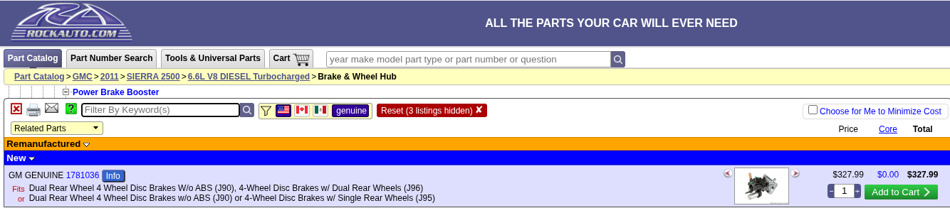

Can I use the 1781036 hydroboost unit (2011 MY only 2500HD)? Supposedly this is a better unit than the others. I have seen many use it on there gmt800 Duramaxes, just wondering if anyone has done it on a Tahoe or Yukon? Sounds like you’d just have to enlarge the hole to fit. My truck (05 Yukon) already has hydroboost, but it is leaking AGAIN. Replaced it a couple years ago, I hear this is is better.

I can confirm it fit my 2001 Suburban 2500.
It was a direct bolt on, I didnt have to mod anything. It does seem to provide easier (less effort braking). I also replaced the power steering pump with a Duramax version from PSC- Also a direct bolt on (with yer old pumps mounting hardware).
While I was at ut, I replaced all the power steering pump lines with Edelman Elite series for max durability!
The 2011 dmax master cylinder is a close fit- bolts right on but the two line fittings are ever so slightly smaller/different thread. My plan is to cut my lines, install the proper fittings, re-flare the old lines and enjoy the larger bore diameter MC. (38.1mm vs 37)
If you have a gmt-800 with hydro b, this is a no-brainer. Not only does it work better, the 2011 Oem GM hydroboost is significantly cheaper than the older model ones. When i bought it it was over 100 dollars cheaper on Rock.

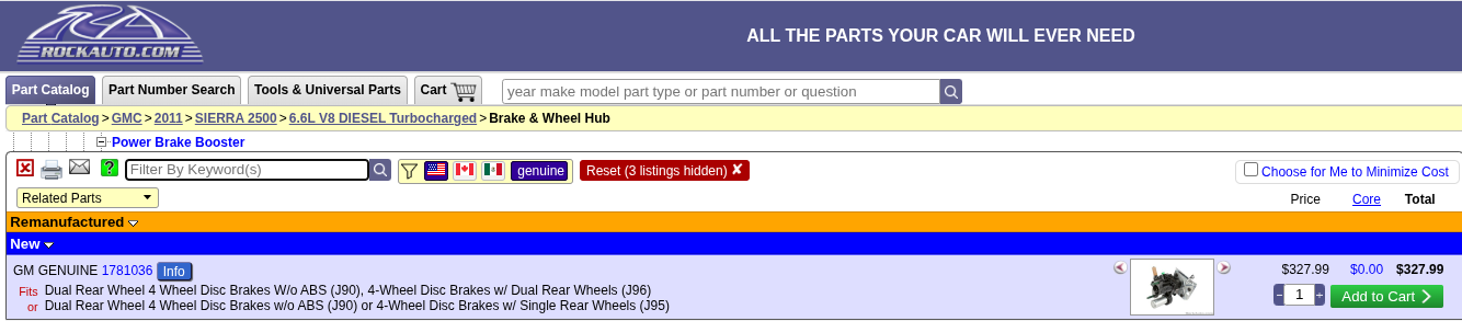

Curious what OEM unit you found? Everything I find is reman or aftermarket.
I bought it from GM parts direct like 5 years ago. They are probably not available any longer. The hydroboost on my Yukon still going strong after 50k miles.

Is this the part number you bought?
