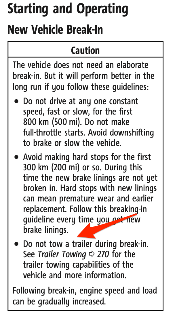

The owners manual is pretty clear not to tow till its broken in. You are not just breaking in the motor. The trans, the differential, and the brakes are all breaking in. A light tow I guess would be ok, but to have no miles and just come right out and tow to the max weight not the best idea.
Yeah owners manual is the best place to check. Unfortunately I don't have one to look at yet. All makes sense it is breaking in all the power train, brakes etc. Ideally I would like to have at least one oil change done before towing but with it being mid summer and camping season my options seem to be limited. Will get as many miles in before towing

just go to GMC web page, Support, Manuals, and download it. Great reading. I did that for my Tahoe while I was waiting for it to arrive.
I read thru it about 2 months ago shortly after ordering my tahoe the 1st time. I will do it again, after i get home from vacation

Off topic alert! Item two about hard braking. At less than 100 miles I had an idiot turn left in front of me. I was going 60mph. Had i not braked hard, I would have hit him. He barely made it by me
Sometimes you have to do what you have to do to stay safe.
