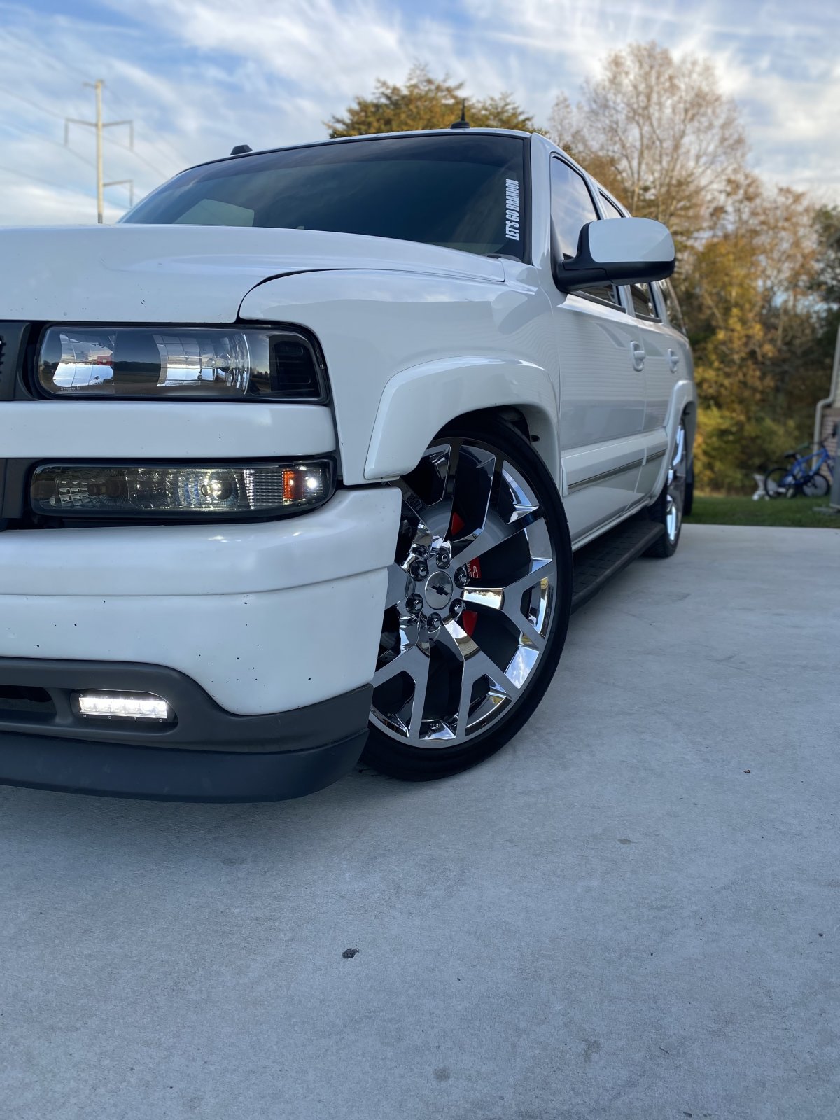

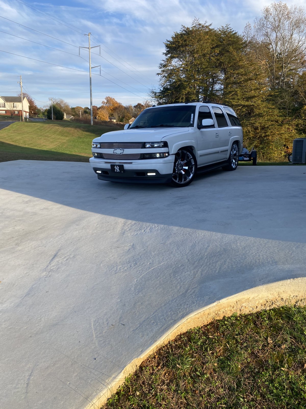

I have mcgaughy 2 inch spindles an 3/4 ton purple keys. My alignment guy said I’m bottomed out on the Camber but it’s perfect he said. If I went lower I’d have a problem. An I’m pretty low in the front.
