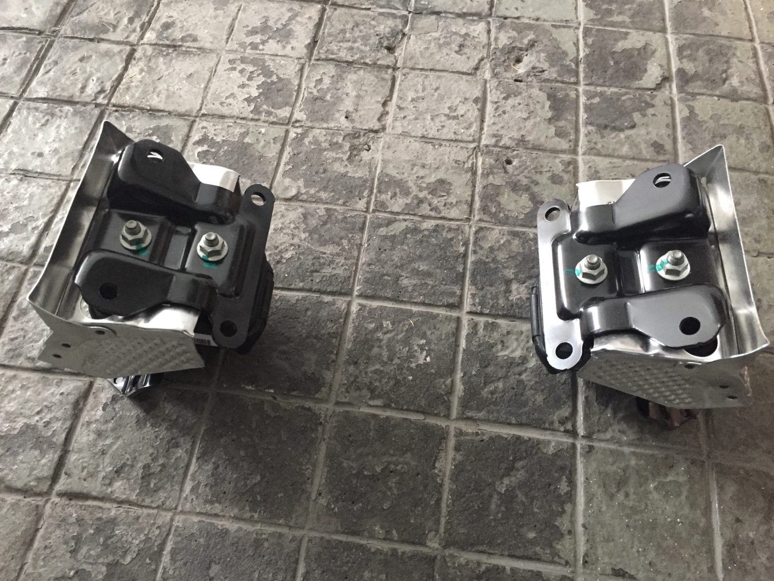

unfortunately no, I just checked their catalog last night and it stops at 2006. I just picked up a new AC delco from the chevy dealership and it has a new bracket mounted between the two plates that seems to be a better design. It cost be $116 out the door but it seems to be worth it. Just hoping autozone will exchange and refund me the broken one.

Pics and/or part number?

I just got two motor mounts for the passenger and driver side, the part number is on the pictures
