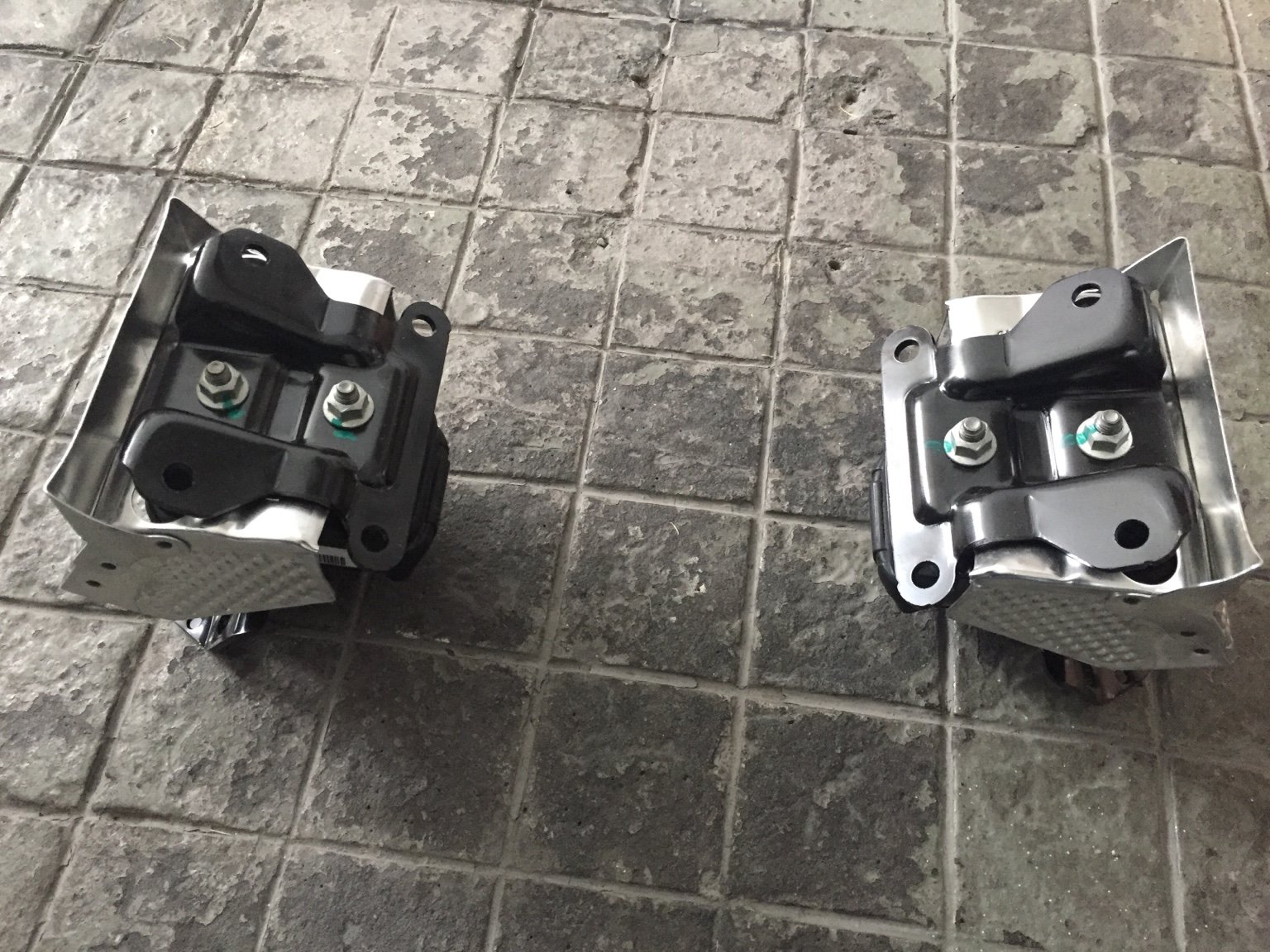

I just got two motor mounts for the passenger and driver side, the part number is on the pictures
Thank ya! Researching...
