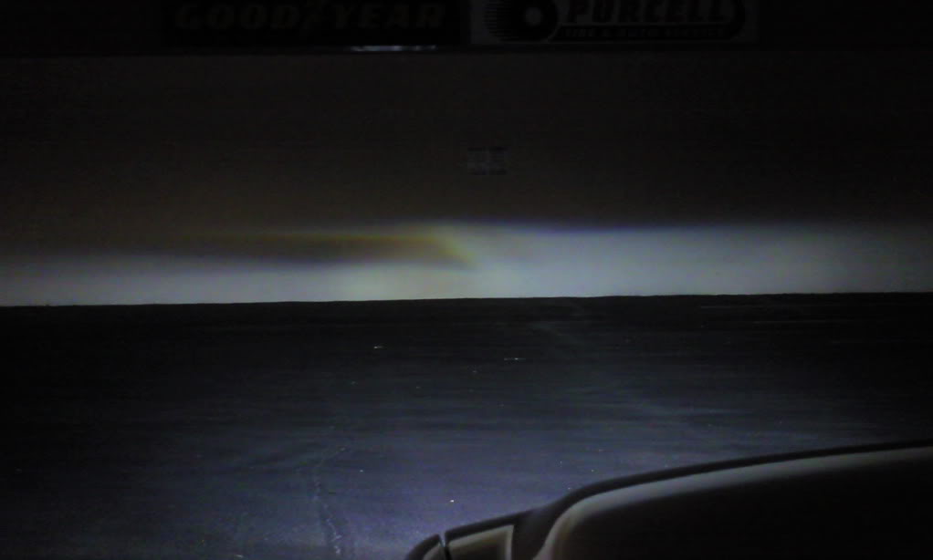

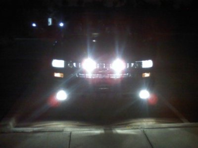

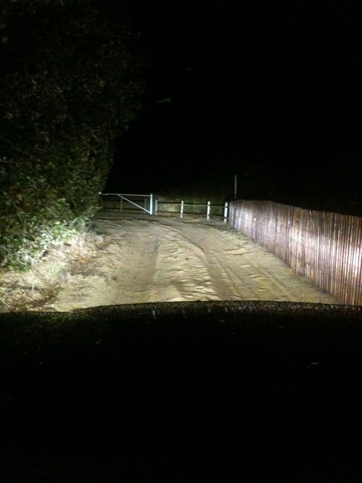

these are just 70W hids, no highbeams on no fogs on, Just the HIDS alone. the road is narrow, but you get an idea for the brightness atleast.
Now to see the difference, look at how much more light there is with the 70W

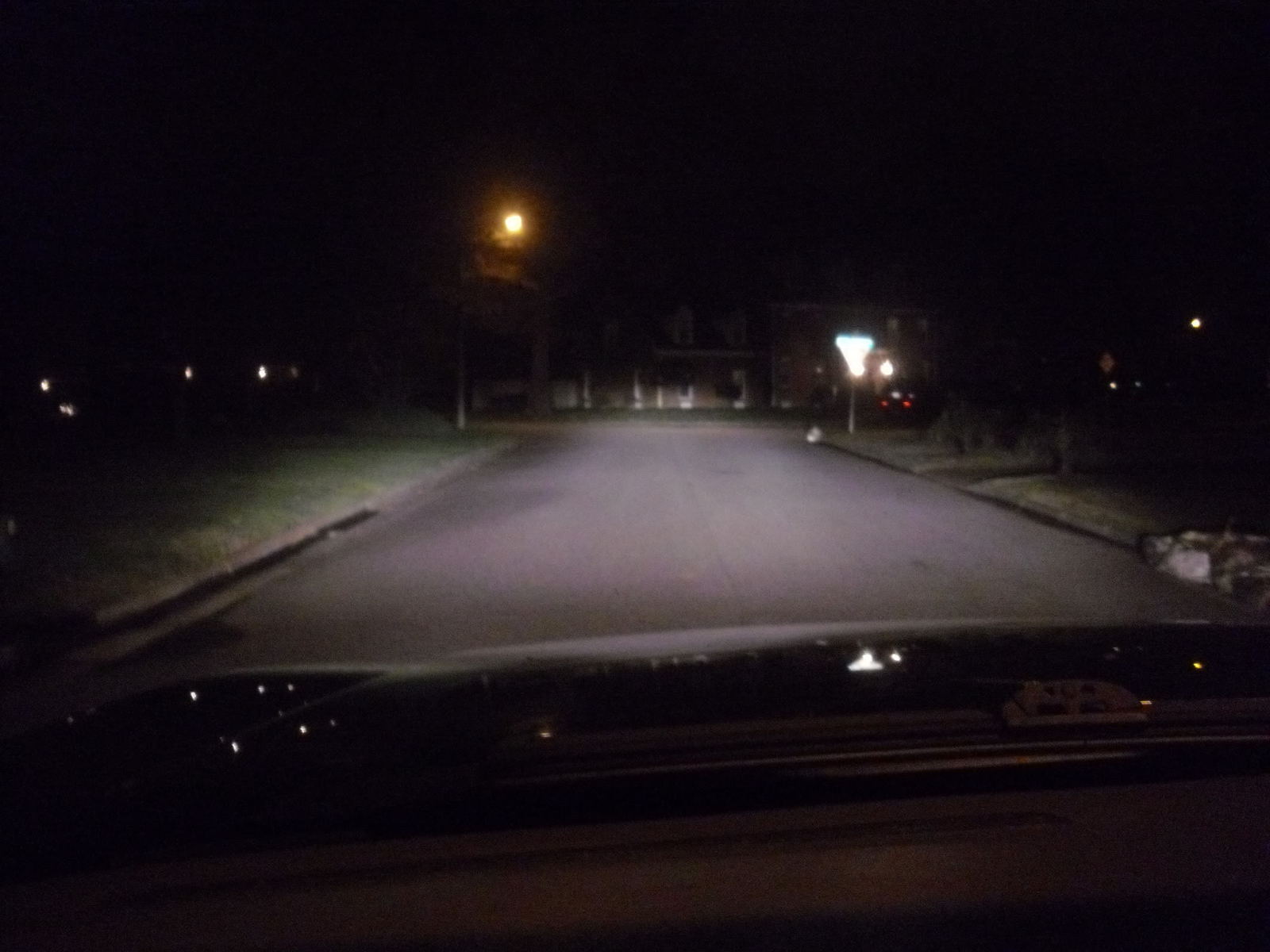

Here are 55w, just to show how wide 55W is, the 70W are even better.
just lows no fogs or highs.

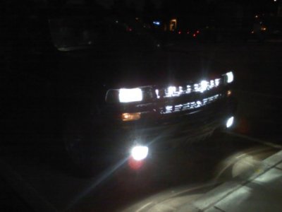

I have a Tahoe, so alittle different, but I had some Halo projectors before, and they sucked compared to my Depo projectors I have now. I would not do it, but then again, Have never seen the light output from these. I do know, stock Yukon projectors are ok, but again, would probably go Depo or TYC. just my opinion. Heres a pic of my Depo headlights
Now, this pic is taken in Phx, AZ, where it's not pitch dark. Wasn't in a alley, or where lights aren't around. So, for the city, and being halogen projectors, not retro job, pretty good output I think.
