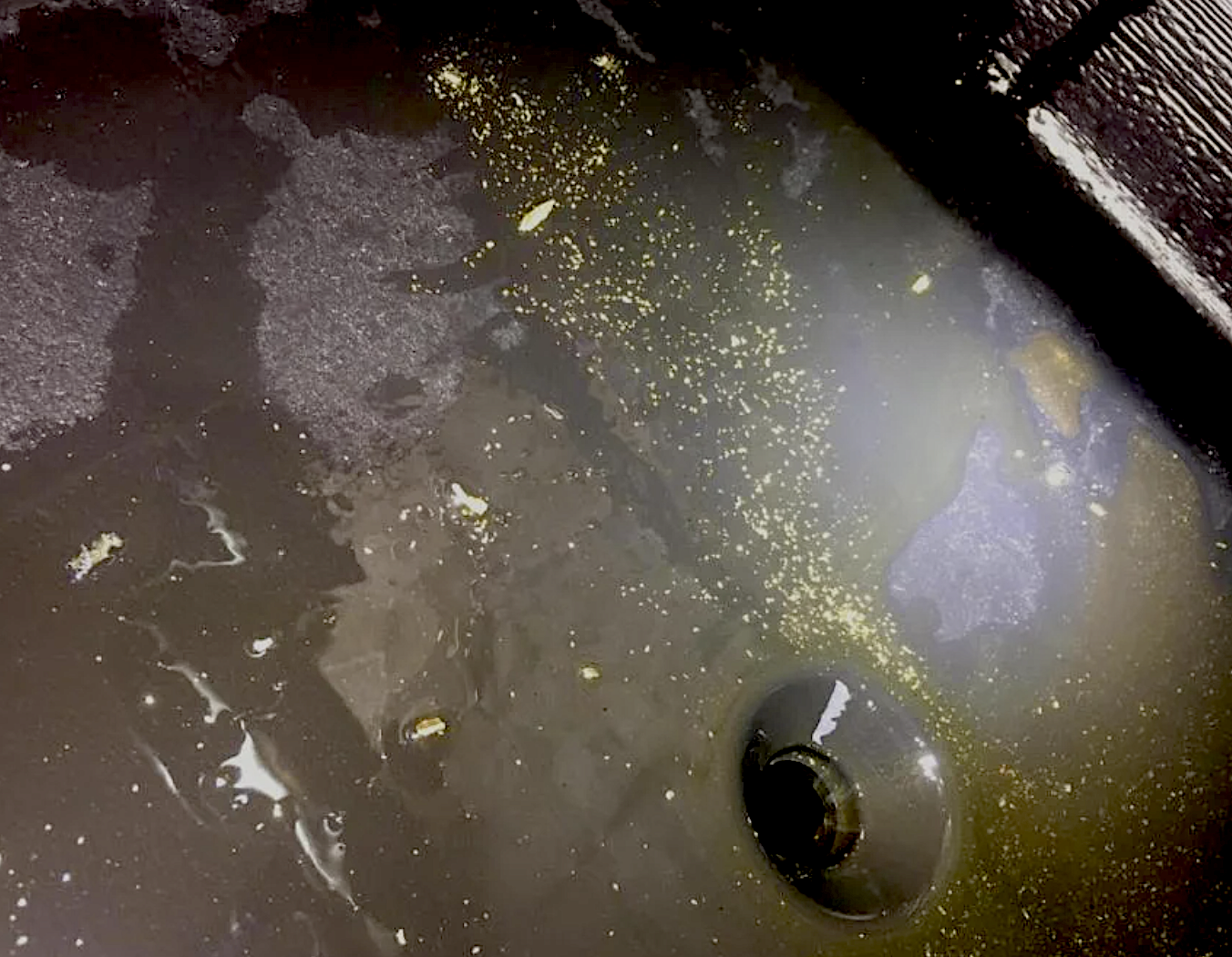

Hey folks, giving an update after my recall replacement 5/30/25.
Photo of first oil change at 2K miles. Chunky glitter!

That appears to be the 3rd engine that 0x_2a has had in his vehicle. I believe this should be a build after the July 1, 2024 magic fix date.
A lot of metal in the pan, I hope he has the oil filter and can cut this open for inspection as well.
