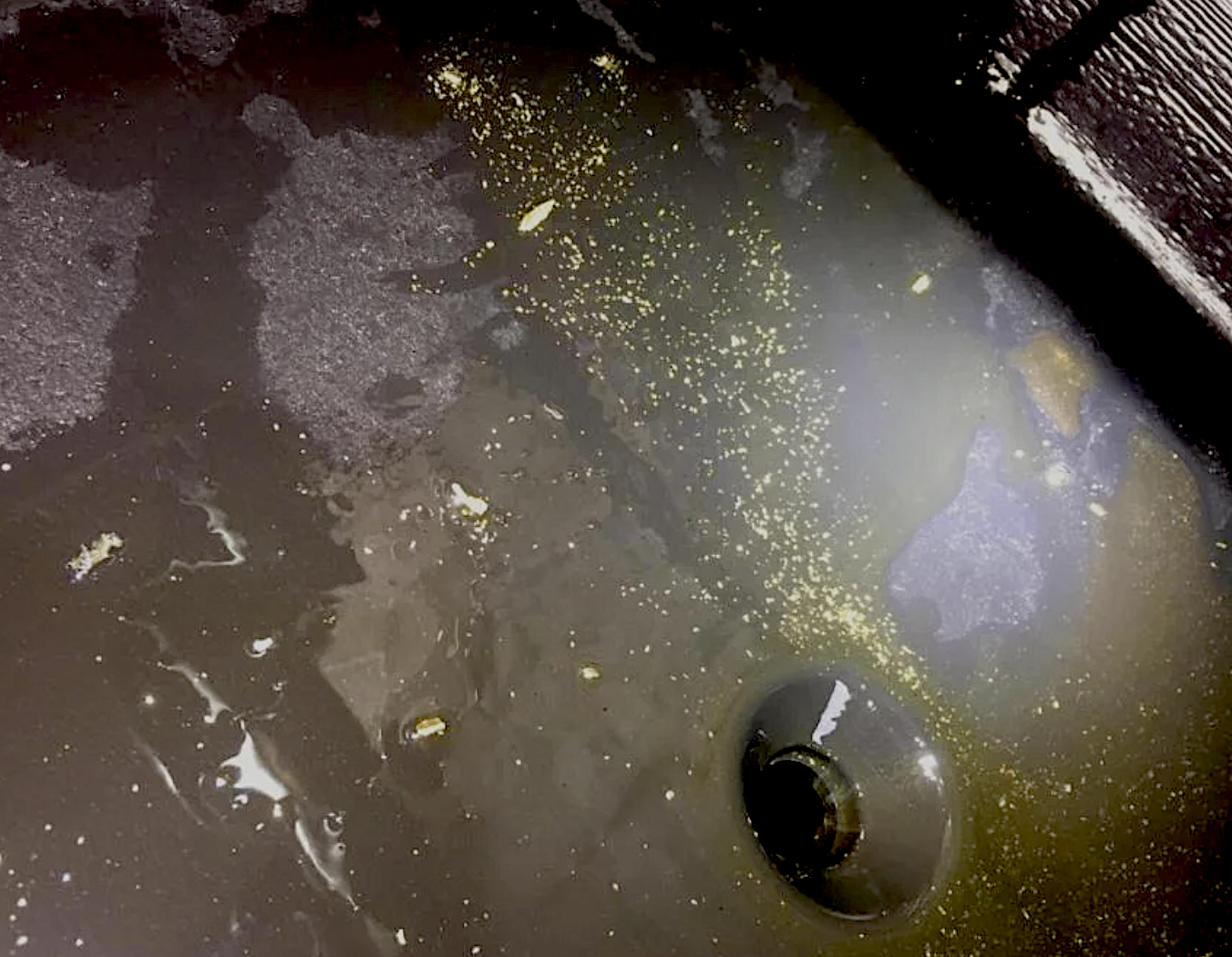

@jfoj thanks, yeah this is my 3rd motor (replaced as part of the july 2024 cutoff recall).
Here's what's in first oil change at 2,000 miles on motor #3... so tired of GM ********.

Man your whole situation is not good. Save your oil filter and cut it open as well if you still have it. I just cut the first oil filters open on my 2024 and 2 - 2025 6.2l. all had some metal the 2025 with 1200 miles looked the worst. I also did not like the oil color of the 1200 mile 2025
Document everything you can on motor number 3, I do not have a good feeling about#3 between the noise and what the oil drain pan looks like
Search my user name and Post Pictures of Your Oil Filter Opened Up.
GM needs to be doing random pulls of oil filters and cut them open after Cold Testing and track what is going on, this is crazy and bad for all of us owners.
