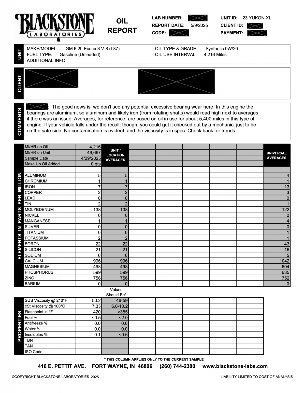

I had my oil changed a couple of weeks ago and my dealer put in Mobil 1 0W-40 Supercar oil per the recall (but didn't perform the recall since it hasn't been released yet). That cost me an extra $37 or so more than normal. I had them take a sample of the 0W-20 that they drained out, and I sent it to Blackstone for my own peace of mind. For reference, my Yukon XL has 50k miles on it and this was the 10th oil change. I had the first one done at 600 miles and then changed it roughly every 5-6k miles since.
I've attached my analysis. Thankfully all of the numbers look good and there's no sign of bearing wear. Maybe that'll help reassure some of you with higher mileage engines. But seeing how several people aren't getting any warnings before failure, I'm still a bit concerned. Especially after seeing Vladimir's post today :(.
Interesting with all the talk about fuel dilution, your's was less than 0.5%. Go figure.

The problem with fuel dilution you really never know how bad it may be until after the fact. Local climate and driving conditions/habits factor into fuel dilution. A kot. Also the sample was taken at about 1/2 the typical oil change interval. I assume maybe a lot of highway driving?? I would be surprised if this sample was taken after Winter driving in the North East.
I should have posted my driving habits for reference. My previous oil change was at the end of January and I live in the south, so the weather was pretty moderate over those miles. About 15% of my miles are towing a 7,200lb travel trailer on the highway and the rest are mostly 15-20 minute drives in city traffic.
