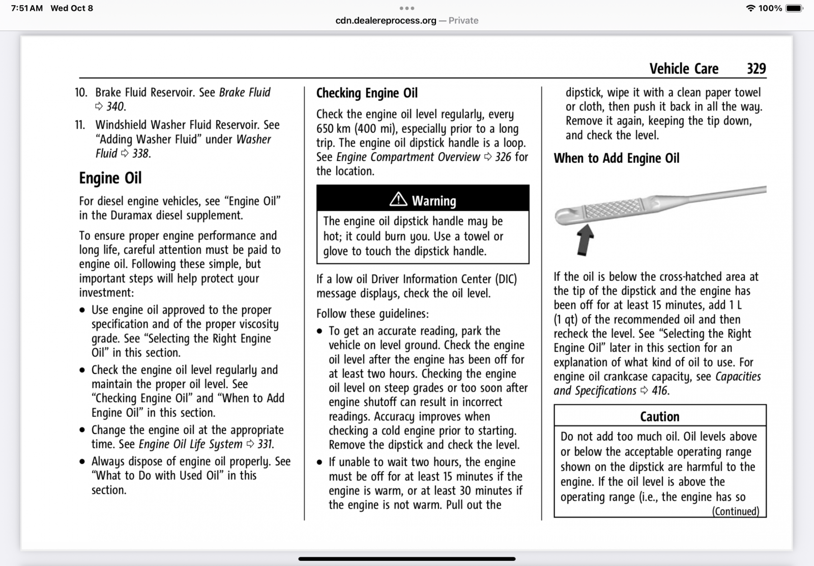

The vehicle owner’s manual for my 2024 Tahoe Premier states that when checking the engine oil, you must wait two hours after engine shut-off to get an accurate reading.
You are checking your oil after several minutes of engine shut-off. Perhaps that is why you do not have an accurate reading on the dipstick oil level, and are overfilling the oil?
What does your 2024 GMC vehicle owner’s manual say?
I check the oil level not only when the engine is cold, but also during long trips. My driving habits are such that over 750 miles, I can lose 0.5 liters of oil. So, here's the point: I timed how long it takes for the oil to drain back into the crankcase after the engine is stopped, and it's visible on the dipstick. I can say with absolute certainty that it's within 5 minutes. That's about 0-20 oil.
Immediately after stopping the engine, the dipstick will be dry, and you can check the level after 5 minutes. The level won't change after 10 minutes, 15 minutes, an hour, or overnight. However, when the oil is hot, it's too thin, so you need to carefully examine the ribbed surface of the dipstick to see where the oil level is. Otherwise, after 5 minutes, you can safely check.
