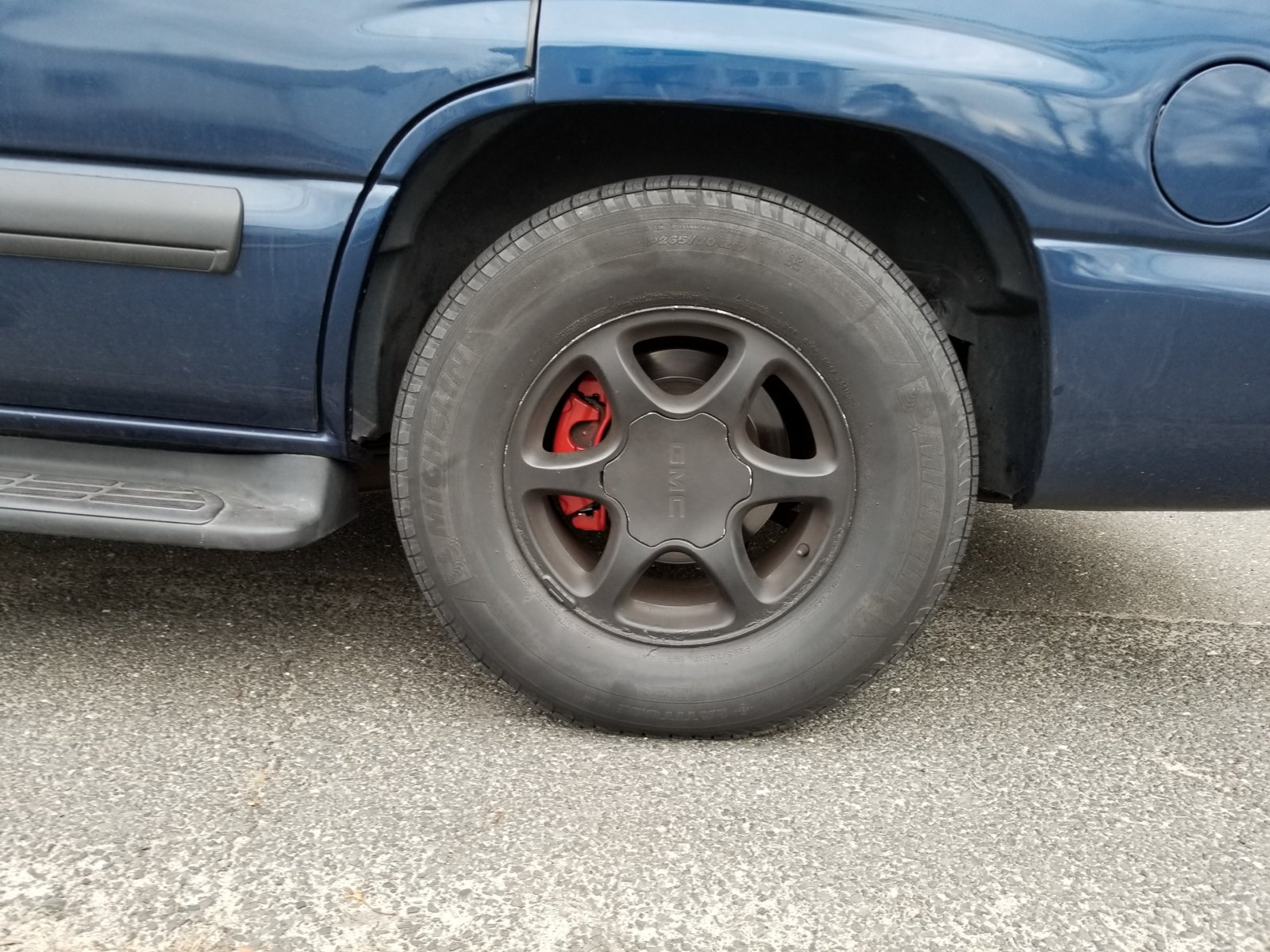

I'm not sure if it goes up to 13, but I used a setup from an 07 on my 03. Only requirement--you need 17" rims, or the setup will rub.
Through my 17's.
