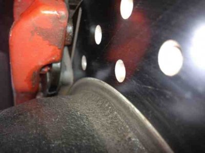

This is what it looks like when truck is running and in gear. This is not normal
Front
Rear

Had it towed to a different shop today and they called saying SO FAR it's the master cylinder and have to replace it in order to see if anything else defected.

Never knew that burb and I completely understand what your saying but here's my output on that if I installed the pads incorrectly it should have showed signs miles ago I've been driving the truck a lot lately for the a/c usage since my DD doesn't have a/c and it was driving fine no smoke no smell no noise until last Friday after been park for about 3days prior to a week of stright driven 30 miles 6 days a week and I dont think installing pads incorrectly would cause front and rear calipers to hold onto the rotors as seen above while vehicle is on and in Gear (D) now if I'm incorrect someone please let me know
