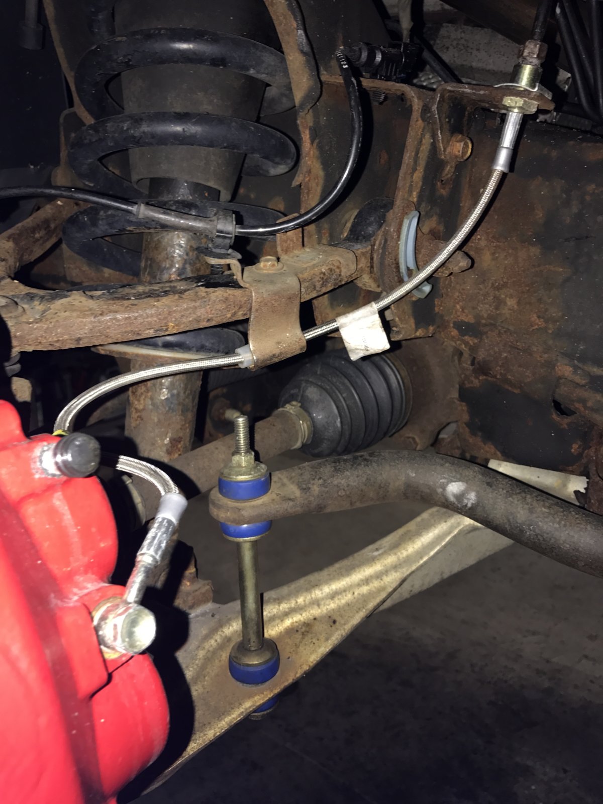

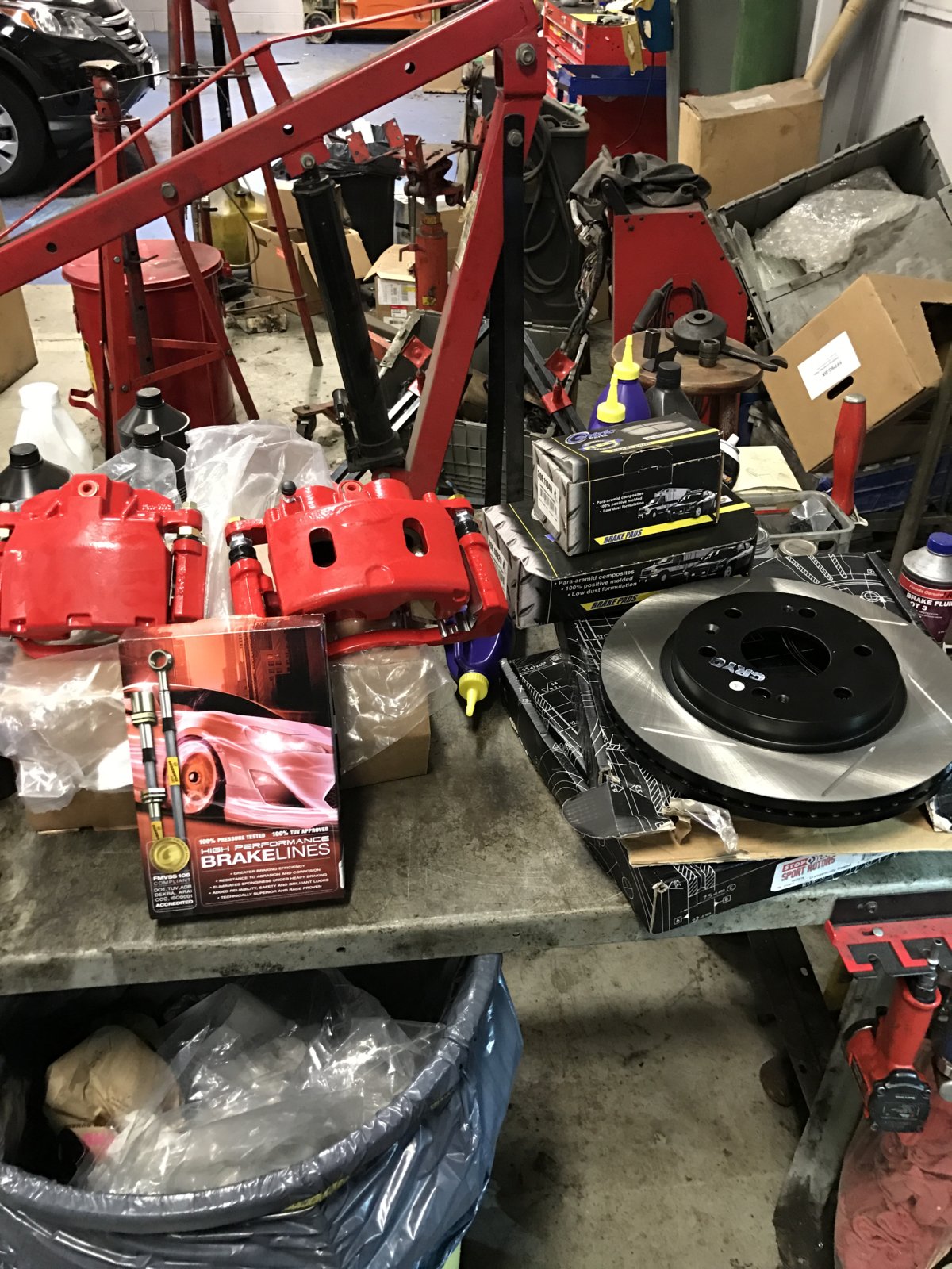

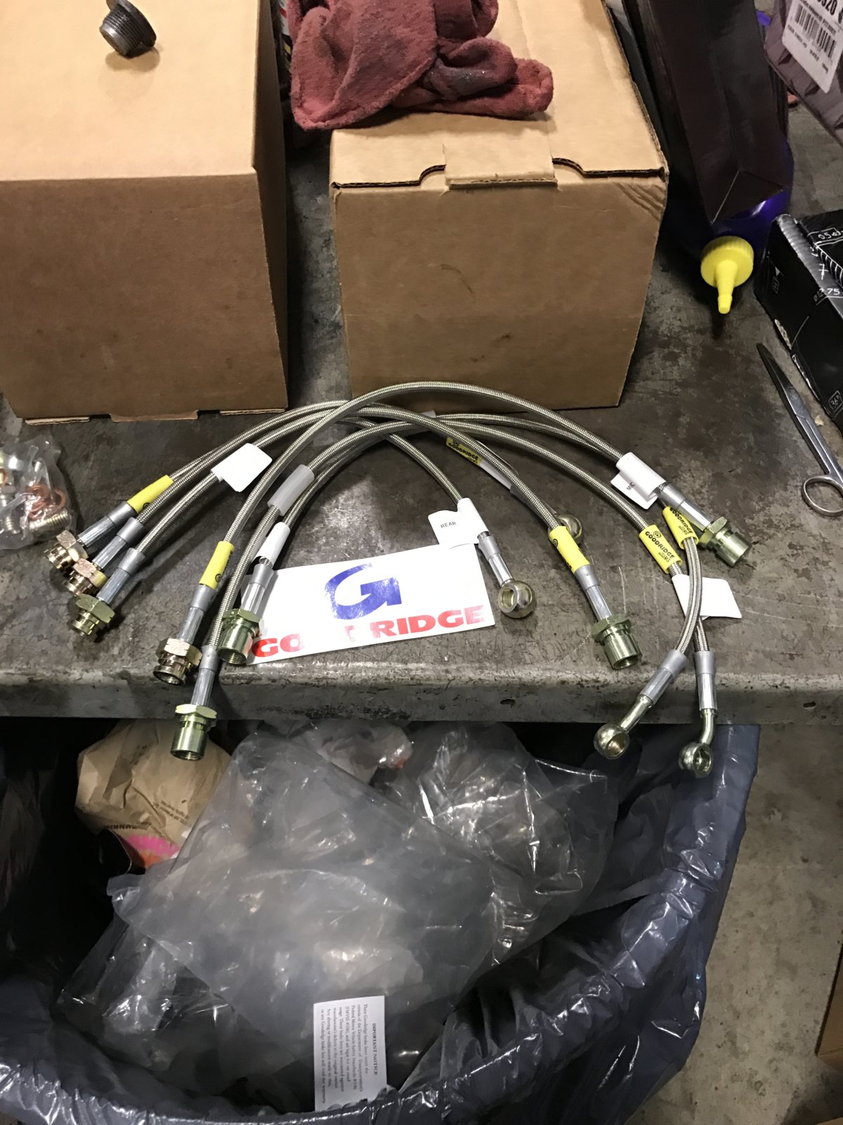

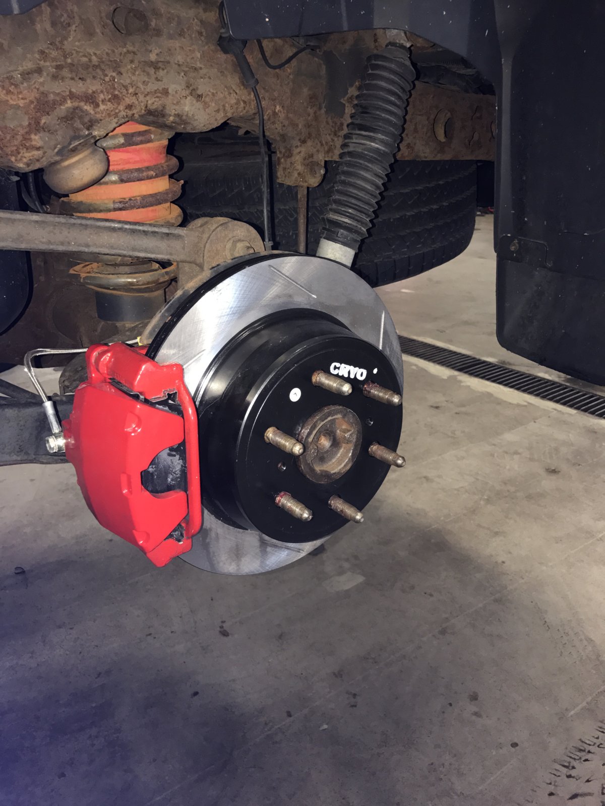

I went with powerstop cryo slotted rotors, pads and steel lines. I came across a few concerns when it came to slotted and cross drilled rotors where some brands were cracking starting from the drilled holes.
The only problem I have with the slotted is it creates more brake dust than usual.
