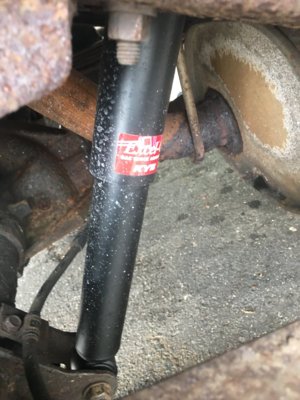

I don't know if this helps but, I replaced the Bilsteins on my barn find, with a set that was suggested to me.
KYB Excel-G 344266
I also own a 96 ExtCab Silverado & the pickup's ride was much more comfortable until I switched to these on my 96 Yukon.
I really like them. they were a great price, and the truck is still tough, but a lot nicer for my back on long or short trips.
I had been running them on 265-75-16s. Then I tried them with 305 70 16.
I found the dampers had good ability with both the highway tire and the M/T.
I'll be mounting a 285 75 16 hybrid tire this weekend for a road trip with mixed driving. I think they'll do well.

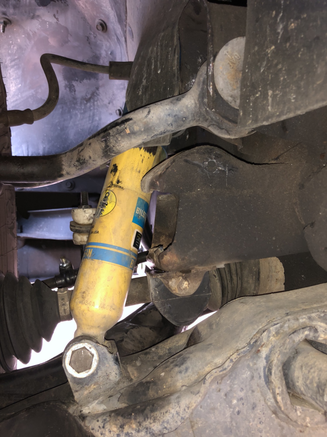

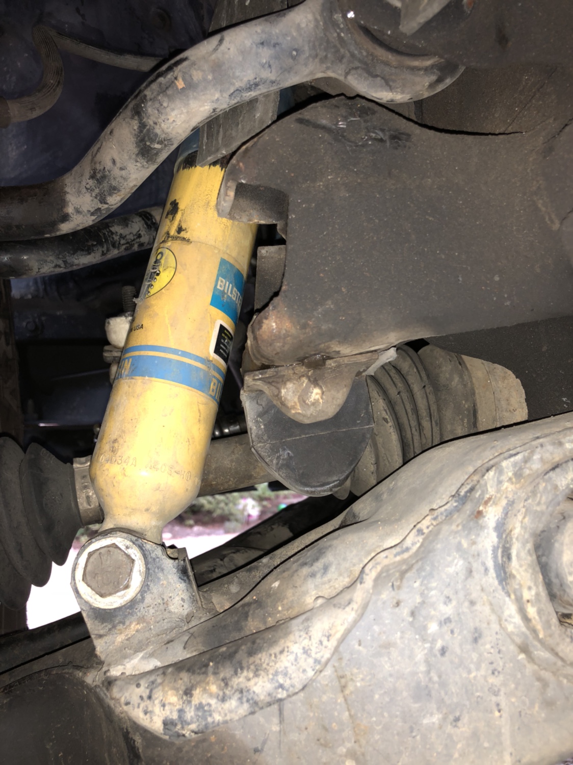

I’d think that the bump stop on the LCA would be the limit with the tire going up, but not sure about it going down. I’d guess it’s the UCA hitting the bracket, but never have paid attention when jacking it up.
I have about an inch, maybe inch a and a quarter, clearance below the UCA and about the same from the bottom of the bump stop to a line across the top of the dimple that it would go into on the LCA.

Thanks for the pics east302!
I'm gonna guess it's just the way it's supposed to be, I'm just cranked up to much to have much down travel left.
When set to factory z height there must be enough down travel that it would rarely hit the bottom end of the travel. At my current setting I think I will top it rather often.
