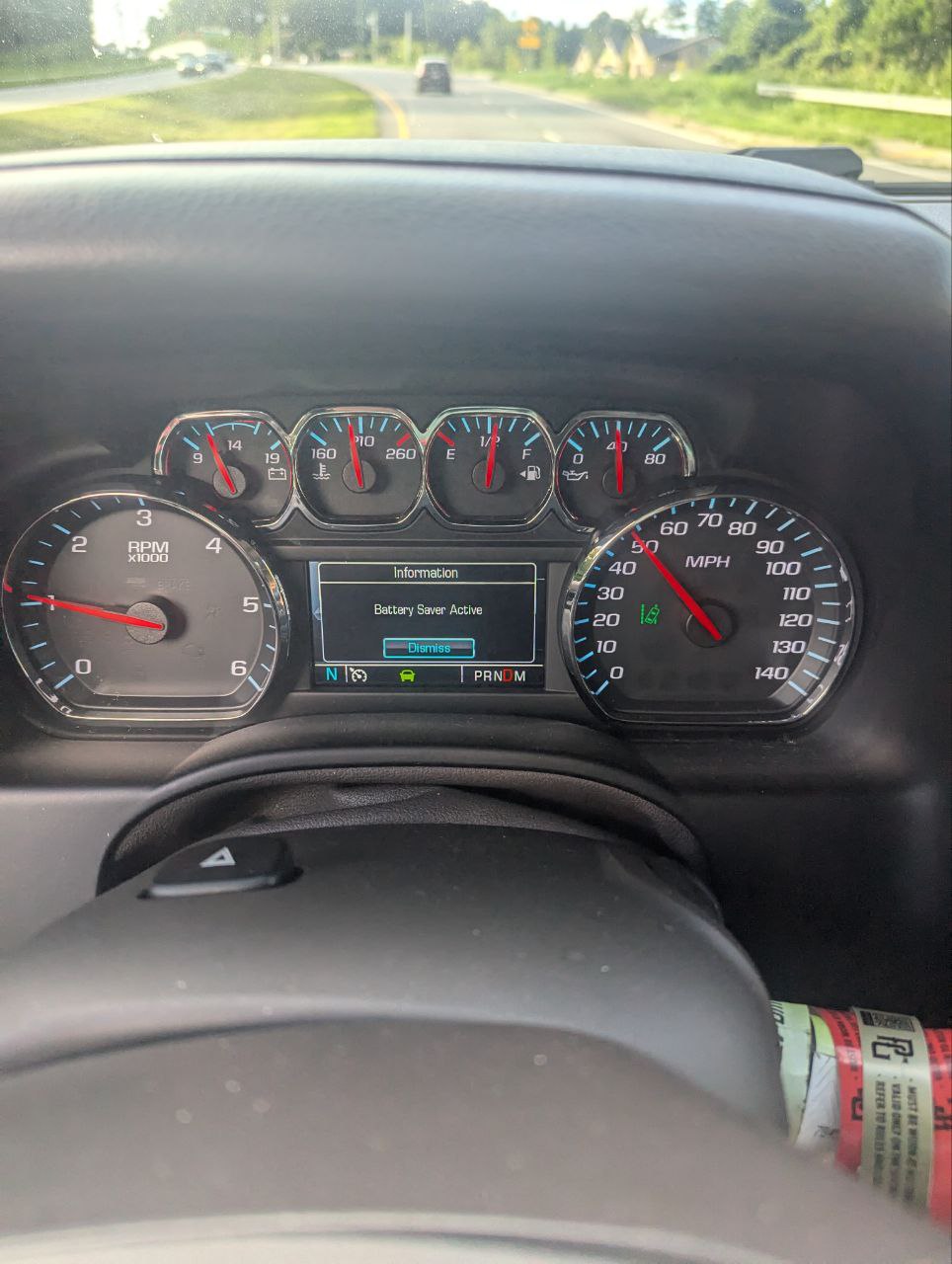

Think I might have a bad alternator on my wife's 2015 Tahoe.
Had a slight whining noise show up about a week ago. I couldn't find anything right off the bat and it didn't affect the drivability so I was gonna wait until this weekend to troubleshoot further. Today she sends me a picture of a "Battery Saver Active" message on the DIC with the batter gauge at the low marker of the normal range. When she got home, I went out and did some preliminary tests with my multimeter. Just testing the battery with the car off, it's right at 12V. Cranking the car up and then testing (which I've never done before but ChrisFix recommends) the voltage was below 12, around 11.2. According to his video, that indicates a bad alternator. I can get an alternator from Amazon delivered on Sunday, or I can pay twice as much and get one from the local auto store tomorrow. Can I wait it out or is this something that will leave her on the side of the road? The message didn't show up when I had it running so I'm hoping it's just slowly on it's way out and not completely dead.

It will likely leave her stranded, the battery alone will not provide the engine with the correct voltage long enough to get very far, I'd say park it until it's fixed unless you want more headaches

That's what I'm afraid of. From where she took the picture today, she drove 35 minutes home with it like that today. Perfect timing for us, when everybody has somewhere to be at the same time.

That video doesn't apply to you. The old style alternators used internal voltage regulators. The alt would constantly run, and would aim for a desired voltage (14.4v), then shunt the overage to not overcharge. Starting in 05, the alts had external voltage regulators, and are controlled by the BCM. The alternator is designed to fluctuate, and be ran at lower voltage. Instead of always running, it is designed to run when there is a need for more voltage. It does this to improve mpg. There is a short mention about it in the owner's manual. What you listed is within spec, and doing exactly what it's designed to do. Nothing you have said so far is a problem with the alt, (without knowing where the noise is coming from).
