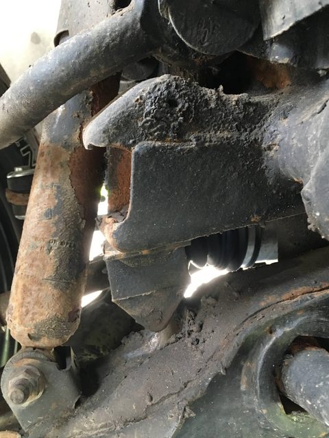

I bought this 98 2 door Tahoe earlier this summer, and have been getting it mechanically up to speed. My goal at them moment is to get the suspension heights set, then get shocks and an alignment done.
The previous owner did some torsion bar cranking I believe. The adjustment bolts are almost 3/4 of the way. I've read a bunch on the wear and tear of the front end from cranking to much, but I can't seem to determine what to much is. I also don't really know what it supposed to be like from the factory anyway. From these pics, can some one tell me if these angles on my front suspension are bad?
Here's my passenger side front;
Here's my driver side bump stops from behind;

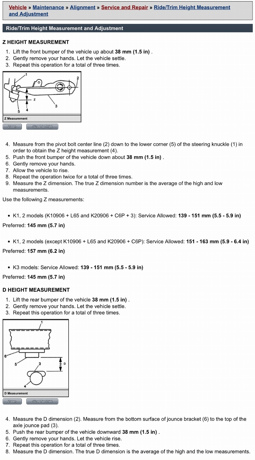

In case you’re looking for where “stock” is, here are the factory specs for the ‘z’ height as adjusted by the torison bars. Use the 5.9-6.4” values.
On my 98, it’s about 36” from bottom of front fender flare lip to ground with 285/75/16 tires. I want to say the back bottom fender flare lip is maybe an inch higher.

Thanks for the info. Went and measured. My Z height is about 7.75 inch. Quiet a bit more than the optimal 6.2 inch. If I drop the rear blocks down from 2.5 to 1.5, and keep around 2 inch of Rake, I'll be lowering the front about .75 at the fender. It will bring the front closer were it should be, but I'm guessing not by that much...? Question is will it make that much difference in the longevity of the front end?

A lot of people just level by cranking the front up around an inch, inch and a half. I couldn’t see that making a huge difference in longevity of parts. Your setup doesn’t look too extreme, either.
