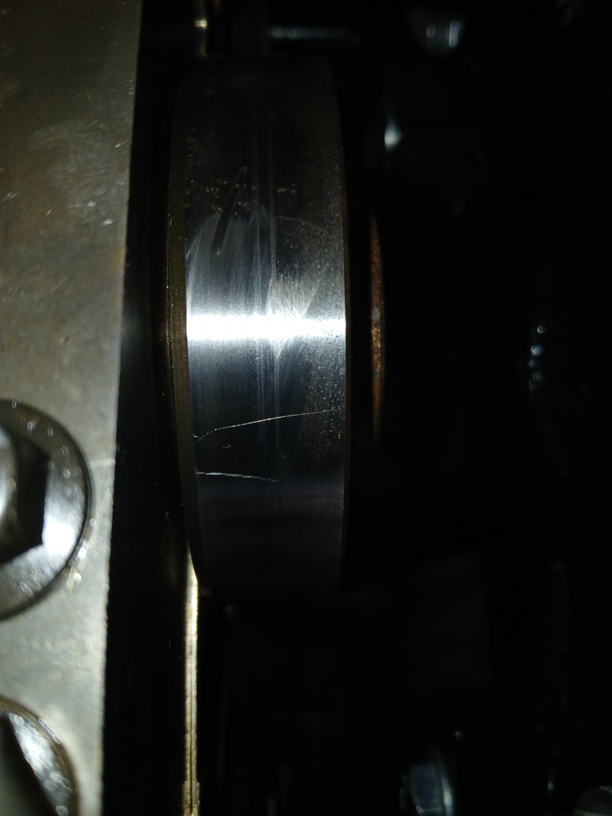

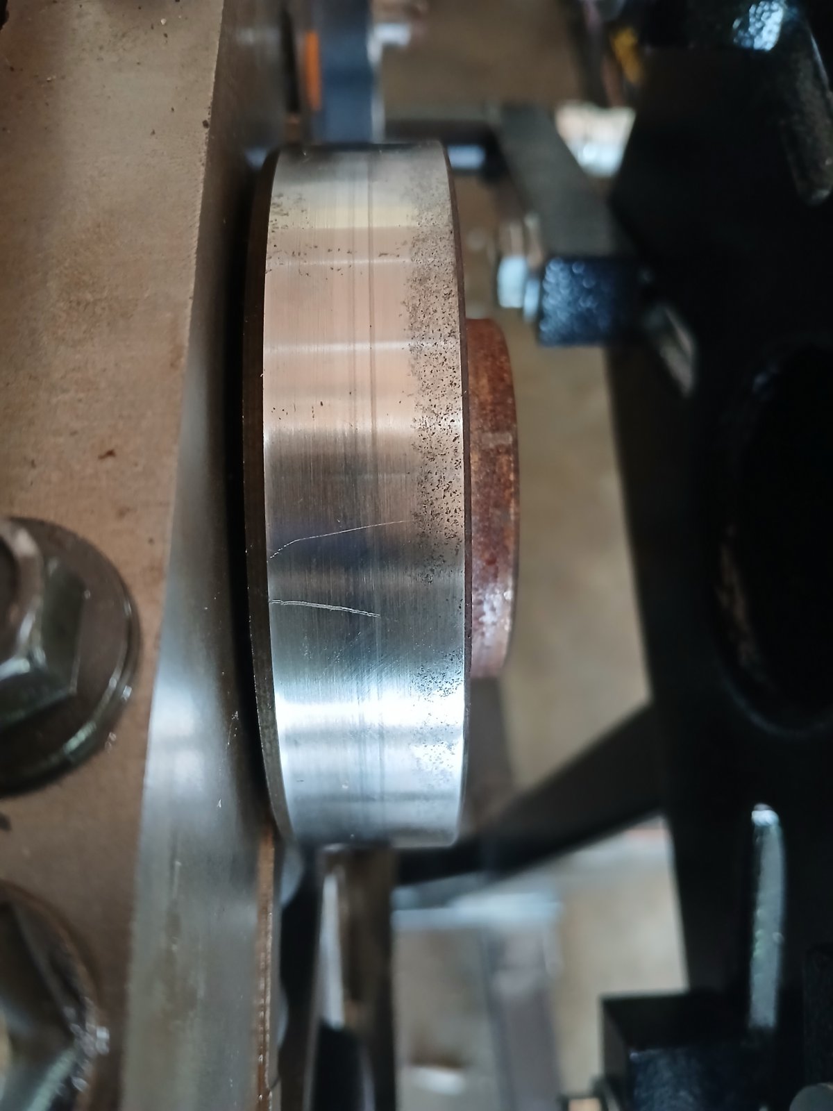

Also I was looking at the crank and the machine shop said it was fine but I noticed a hair line scratch or crack

Hard to tell. Does it catch your fingernail? I think that's going to be fine. I wouldn't really worry about it.
Are you asking about measuring bearing clearances? I assumed the machine shop already did that? If not, plastiguage from AutoZone is really the best way.
Yes it does catch my finger nail.

I wouldn't use that crankshaft with scratches in it that bad. It you have it turned .010" and it cleans up? then great.

I thought I found a good machine shop I had them check the crankshaft afterwards they polished it and said it was good to go. And I doubt I damaged it during transport.

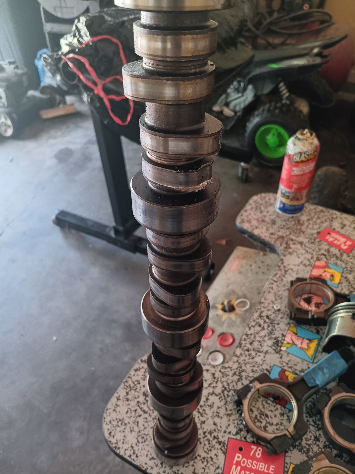

I also decided to examine the camshaft to see if it could be re-used and it looks like one of the lobes has a bad flat spot.
If I'm seeing what I think I'm seeing (4th lobe down)?? that cam is junk.
That will do two things: seep oil from the get go and wear out the seal prematurely. You could try some emery cloth to see if you can get it to clean up but based on that cam, I wouldn’t trust a thing that shop said.

I will try the emery cloth and see if that helps. Im thinking this wont cause much damage. When I rub my finger over it I can barely feel the scratches.

The machine shop I used cleaned it up pretty good compared to how it looked when I dropped it off when I looked at it when I picked it up I didnt notice it. Hopefully it cleans up when I get some time this weekend to work on it. Im trying to keep this rebuild at a minimum I would hate to get another crankshaft then have to get the rotating assembly balanced
