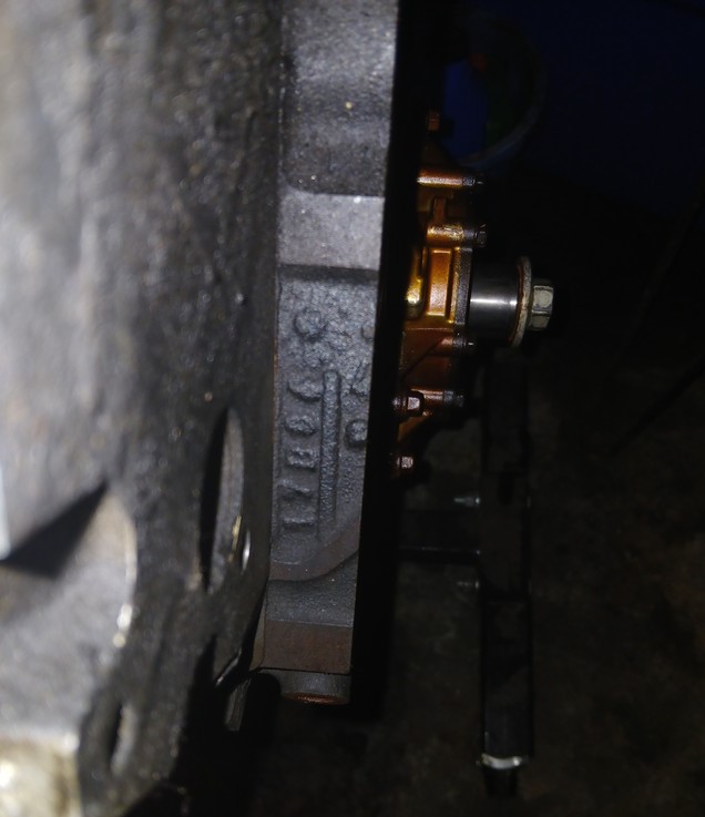

Could this block be possibly 2006 because of the last digit
I was trying to decode this so I can tell which year but not finding much info??
The number below tells me its a 4.8l / 5.3l block 99-06

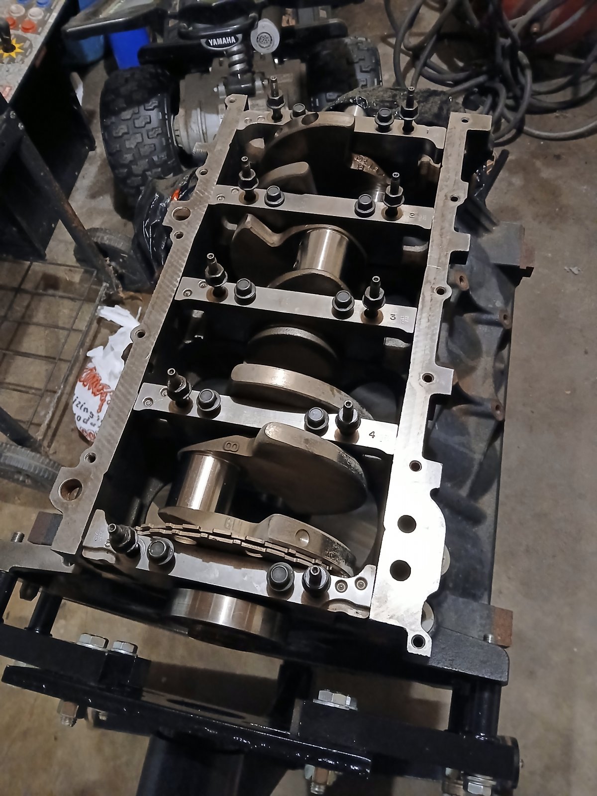

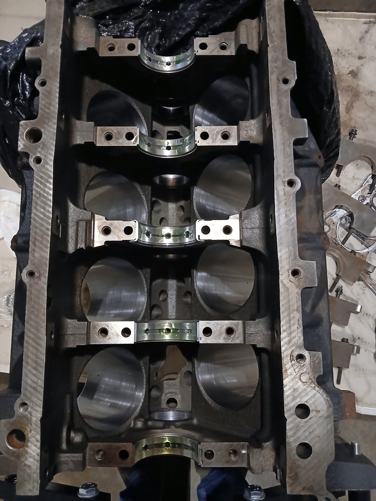

View attachment 428993View attachment 428994
Well the block checked out good still uses std bearings. Last night I got the main bearings installed and used a little assembly lube on them.
Can the main cap bolts be re-used? Also the side main cap bolts?
Very nice!
Main cap bolts can be reused. They are torque -to-angle (not to be confused with torque-to-yield, TTY.) Just clean them up, as well as the threads on the block. And apply a bit of oil to them when reinstalling them.
Side bolts should be replaced (I believe that's what GM advices, but it's because of the pre-approved (edit: pre-installed!) sealant on them. If reusing, apply a bit of RTV silicone sealant under the head. That's what I did on my build recently.
I'm assuming the machine shop installed new cam bearings?

lspann3525
Feb 22, 2023
226
229
Very nice!
Side bolts should be replaced (I believe that's what GM advices, but it's because of the pre-approved sealant on them. If reusing, apply a bit of RTV silicone sealant under the head. That's what I did on my build recently.
Yep new cam bearings and hone cylinders. Polished crank
strutaeng
Aug 10, 2023
1,988
4,284
Dallas, Texas
Oh, I'm sure you know this, but when you torque the main cap bolts to the first torque pass, you are supposed to smack the crankshaft back and then forward a few times each with a dead blow hammer (to seat the thrust bearings). Then proceeded with the final torque-to-angle specs.
Then you should check the crankshaft endplay for specs. A cheap HF magnetic base and dial indicator is best, but I've seen guys use feeler gauges to measure the gap between the thrust bearings and machined surface on the crank.
