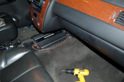

What type of amp are you going to use for your highs? You're gonna need a pretty stalky setup to keep up w/ 2 12W7's. I placed my amp where the factory sub used to be because I was strapped for space. If the amp is not too long, you can also look into mounting it behind the left rear wheel well cover, but then you will have to run a ton of wire to your speakers.

The only problem with mounting it under the console is heat, there is no ventilation there whatsoever. As far as amps go, I had an alpine amp and it fit perfectly under the back seat (wasn't power folding, might want to check fitment first). And what would you need to go to the A pillars for?? The moldings between the seat and the door come off and you can wire under that. Getting wire across the car is another story - going front to back is way easier than side to side. Go under the carpet behind the rear captains seats and you can pull it through in sections.

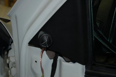

No worries, i didn't like my mounting options up in the a pillar and i was hoping to have the tweeter firing a little more directly and didnt feel like messing up the little Bose grille to do so. The tweeter is black so it's really hard to see against the sail panel and is hardly noticable so I'm happy with it. Thanks though.
I ended up having to run way less wire this way to as i left the crossover in the door panel. Doesnt make it easy to get to but once it's set i shouldn't have to mess with it anyways. I'll post some pics when i'm done.

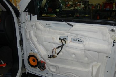

Here's some pics of my install;
Did the doors speakers first, one at a time so that the wifey could use the truck during the day.

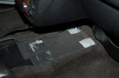

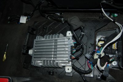

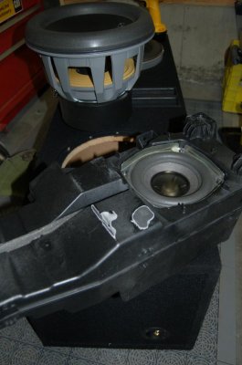

Next i removed the center console and the guts, bose sub and amp;
That sub and box is smaller than the 12W7 by itself.

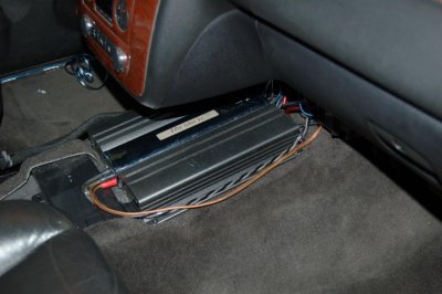

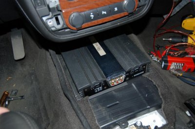

Next i test fit the Amp in place and wired it all in.
That location is awesome by the way. Lots of room and i can remove the cup holders and make any adjustments to the amp that i may need.
