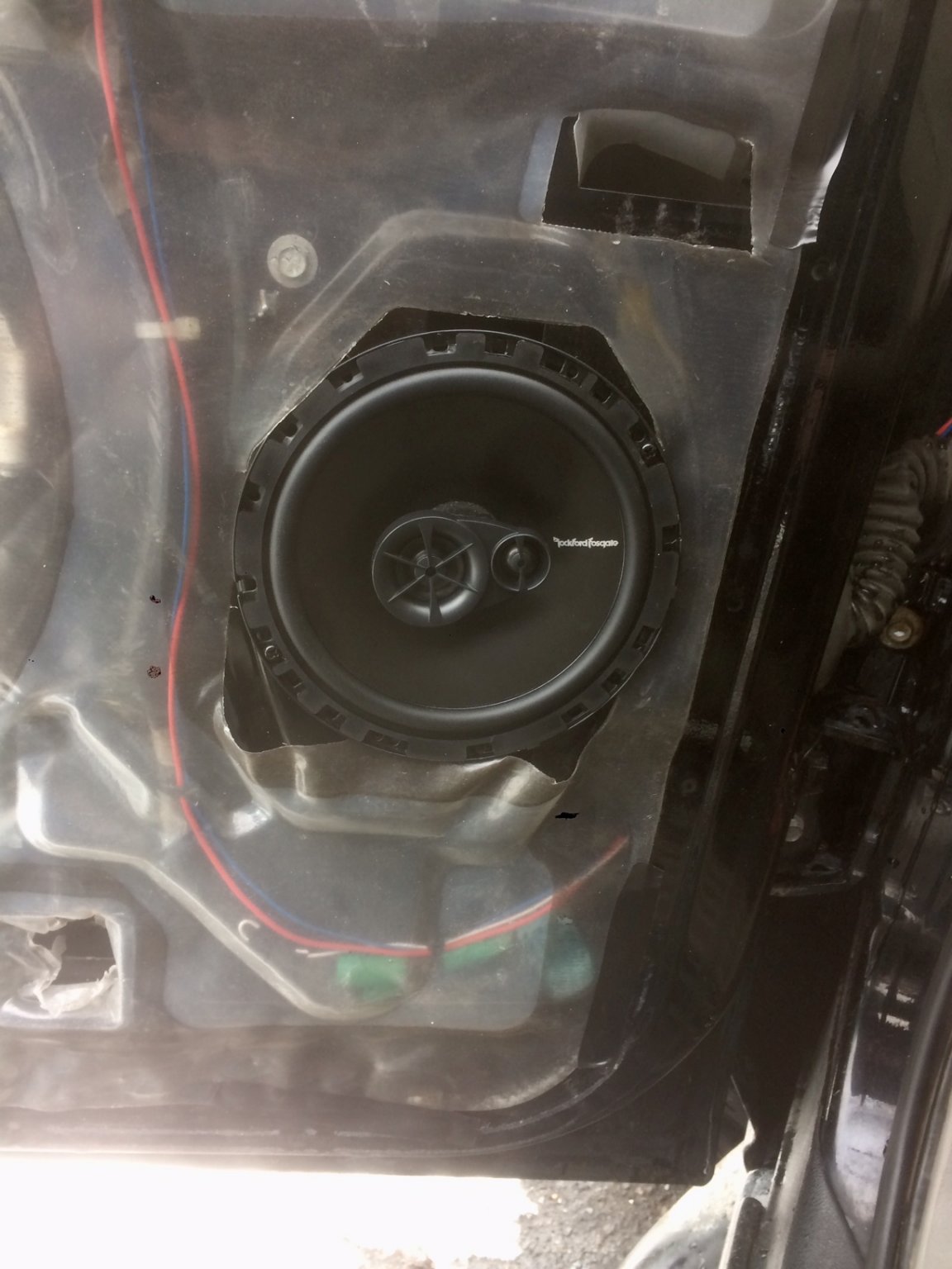

My best advice to you is run all new wiring and avoid lots of frustration trying to bypass the bose. I installed all new door speakers and a new hu yesterday...it took me twice as long to install it, after i repaired the hacked up harness, i was getting no sound through the new speakers. What i did was use the orange(constant 12v power) green(switched 12v power) black (ground) to power up the new hu and ran all new speaker wire from the doors back to the hu until i hook up the amps
I taped up and tucked the rest of the wires on the wire harness as far back as i could bury them.

I had the standard gm radio in which i took great pleasure smashing it into the dumpster lol...i really should of taken pics of the abortion the po (butcher) performed hacking the shit out of the wire harness. I basically had no other option but to run all new speaker wire back to the hu which was pretty easy to do since i left myself a piece of drag string to get back through the door grommet

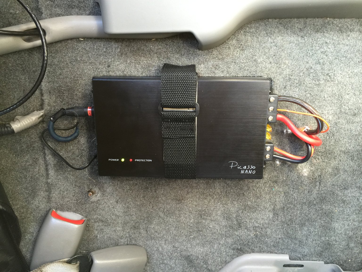

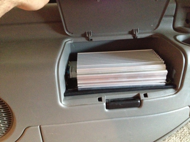

And if you go with the Thunderform enclosure, here's a couple pics of how I mounted my LUX amp if you decide to keep yours. You can also mount a different amp there. This is the only way to keep the LUX amp with the Thunderform enclosure without lengthening the wires. I also went with a JL sub instead of the Polk in the picture, running off a Picasso Nano amp. As you can see, the LUX amp is pretty decent. I'm not sure on the specs but it definitely pushes the new door and rear pillar speakers.
img_4332-jpg.65471
@Red Rocket thanks a lot for the pics very useful I believe I'm gonna do exactly what you've done with you sub and amp setup. I got lucky and purchased a 04 denali bezel a while ago because I couldn't see myself being able to hack up a perfect bezel
