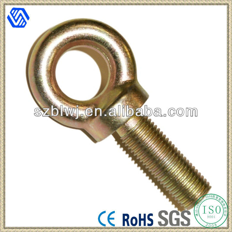

Have any specialty bolt stores or Grainger around you? If you don't find a hitch before then, you could replace the bottom two bolts with some Grade 8 or 10.9 shouldered eye bolts:
Brilliant idea! I have a Fastenal close by, and their website shows they have shouldered eye bolts. Time to make a run over there!
That turned out to be a really good idea... Now to see if it holds! [emoji848]
