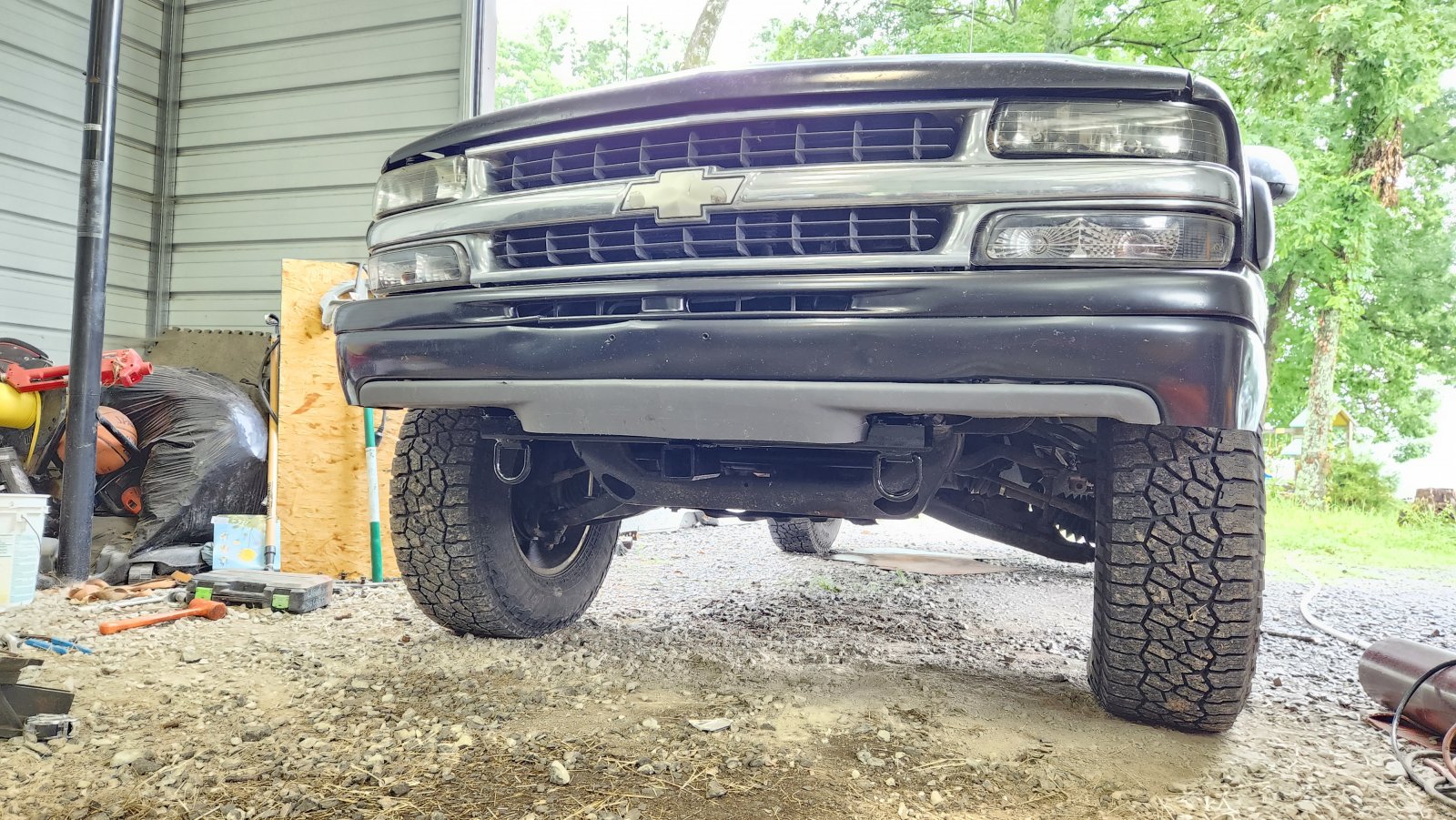

Hey all! Built a front hitch receiver for my Tahoe a couple days ago, and I was thinking it wouldn't be too difficult to modify the design to be bolt on. I wanted to put a feeler out and see if there were any interest in a product like this?
The one I built has bottom hanging recovery points since my bumper is trimmed, but could easily be made with front hanging recovery points that would come out where the factory tow hooks are located to minimize trimming.
Could also have either bottom mounted or top mounted receiver depending on if you'd prefer it to be higher or lower in the bumper.
If there's any interest, let me know. I believe I could sell them for roughly $300-325 plus shipping.
If there is enough interest, I may build one as a prototype for pictures. If someone wants to jump in and pay for the prototype, and take pictures of the install process, I'd give a $100 discount on the first.

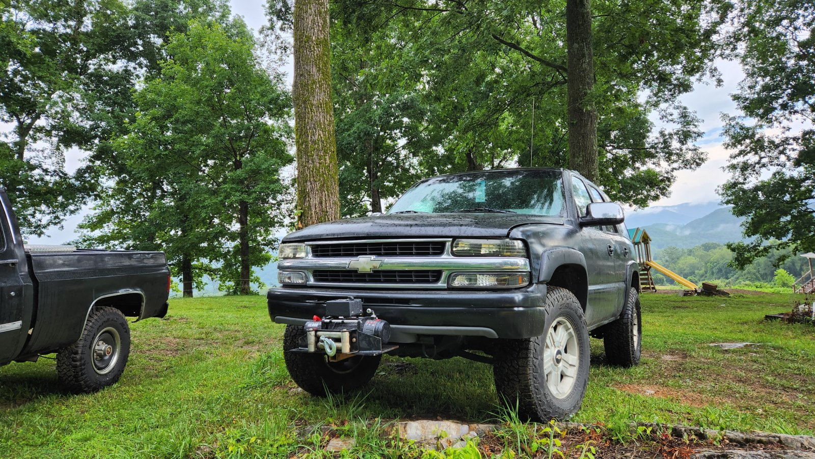

k mainly was hoping you didn't spend alot of time and money because you couldn't find it. snag some better pictures of your setup tho. some people may like your design better.

The "production" model would be a bit different - mine is welded in vs bolt in, so pictures of this one wouldn't help a whole lot.
It would essentially bolt in where the factory tow points bolt, however a bit higher and more robust than the Curt design.

Correct me if I am wrong, however the way you have those D-ring brackets welded on to the bottom of that bar versus the front, I believe that puts an incorrect "shear load" on the brackets and welds.

It all depends on designing with intended work loads in mind. I can tell you from experience using many many of these weld on d-rings that this configuration is plenty strong. Far more strong than the factory recovery hooks. The weld on rings are rated at 5000#, but I can tell you that I have had far more load than that on them with no sign of failure or even deformation. I put them on nearly every bumper I build, and they get used in a similar "load orientation" as to what you see here on my trailers on a very regular basis. Thanks for the input!

I understand - on a trailer you are using them to ratchet strap or chain bind a load, correct? When used in a recovery scenario you are shock loading them, such as when using an elastic recovery rope.

In theory, yes, but let's just say my trailer is used a little harsher than most. That would be putting it lightly.
And the same rings used on the bumpers I've built have been used in recovery scenarios. Both static pull such as with a winch as well as in harsh shock loading scenarios. Kinetic rope when it's been available, but also static straps and *gasp* chains when it was the only [immediately available] option.
Let me qualify that by saying, highly not recommended. I myself would be much more hesitant to use a chain in a shock load scenario than I was in my younger days. However, point stands, the rings and their mounting are plenty strong for the designed use case as implemented.
