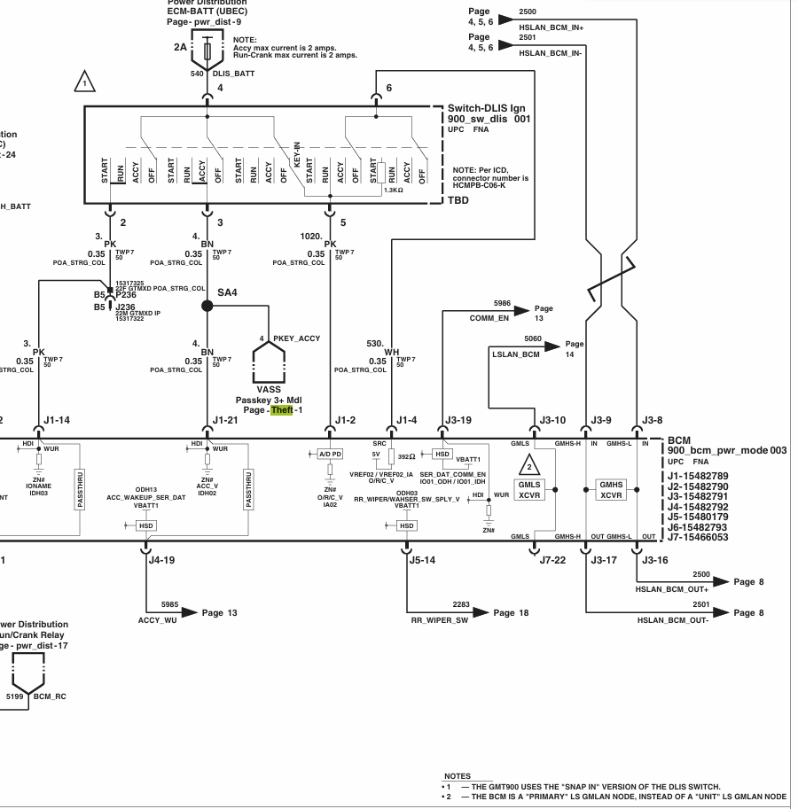

Have a 2007 Yukon. Keep blowing fuse 34 (2A). Have put multiple fuses in and it keeps blowing when turning the car to the On position. What would cause this?

Here's the wiring diagram for that circuit on a 2007 Yukon 5.3L; if yours is different use the links at the top of the page to get to the similar diagram for yours (but they're likely the same):
DLIS: Discrete Logic Ignition Switch
You could try disconnecting the ignition switch feed, and/or the theft deterrent module feed, to see if one of those is blowing the fuse. Or it could be a shorted wire along the power distribution path.

Do struggle to read the diagram, but from what I can gather, it is either the ignition switch, anti-theft module, or bcm. Correct?

It looks like that brown wire (circuit 4) that also connects to a yellow wire to the theft module is wakeup signal.
Might unplug terminal 3 on the ignition, and if the fuse still blows it's your ignition switch.
If not.. plug 3 back in and...
You can try disconnecting the theft module (might be remote control door lock receiver or RCDLR) and see if fuse still blows.
You can unplug J4-10 from BCM to rule out anything else down the accessory WakeUp line (notice the passthrough in diagram below).
If it still blows with both theft module and j4-19 unplugged, then I think it's the BCM (assuming you checked the ignition switch first).

Removed the wires to the ignition switch and anti-theft module. As soon as I plugged in the ignition switch and turned the car over, fuse 34 blew.
assuming you meant plugging in ignition switch without pin 3. If so, pretty confident that is your culprit.
