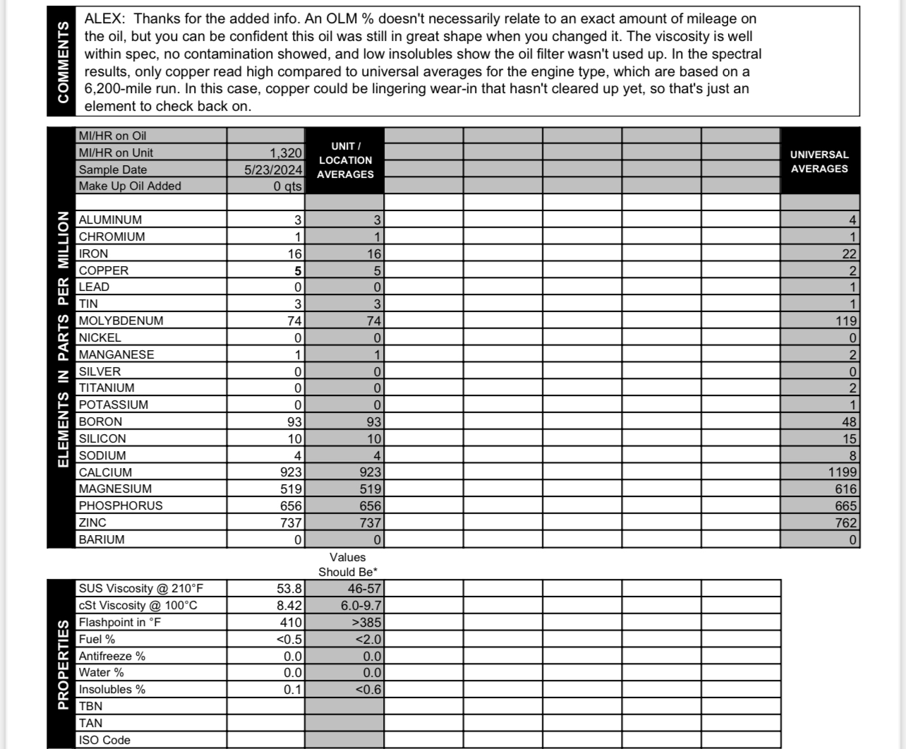

My recently purchased 2022 Denali had its engine replaced at 30k miles. Here’s how the new one is doing after 13k miles. I pulled this sample immediately after the purchase. Enjoy!

Looks pretty good, nothing real alarming that I see anyway. Just out of curiosity, what weight and brand oil was used?
No idea. I purchased this vehicle from a dealer auction. Currently, it's got Costco 0W20 in it. But that'll be changed to something else like 0W40 in the next change.

I wonder where the high copper reading came from? Could be the builder honed the cam bearings to true up the alignment and exposed the metal? Probably no problem in this engine even in the long run.

Doubt it. These are warranty replacement engines. Don’t they come long block from the factory?
