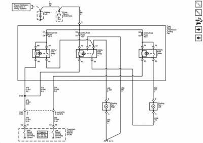

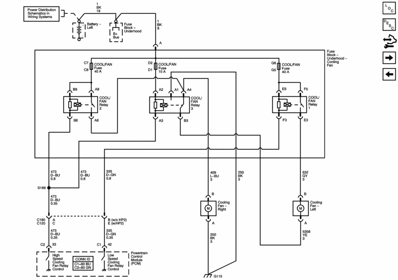

Attached is the wiring schematic for a 2002 F-Body. 2005+ factory fan harness is similarly built. For anybody looking to wire fans themselves, this is how it should be done.

So i un-hooked the fans from the pcm and manually grounded the trigger wires and applied 12v to the FAN harness, and the cooling fans work. So i know my wiring is correct and my fan harness and fans are all working correctly. Following the Factory wiring diagram for an 04 Tahoe, which i got off All Data, which is almost the exact same as you sent me, i checked my wiring and it is correct.
