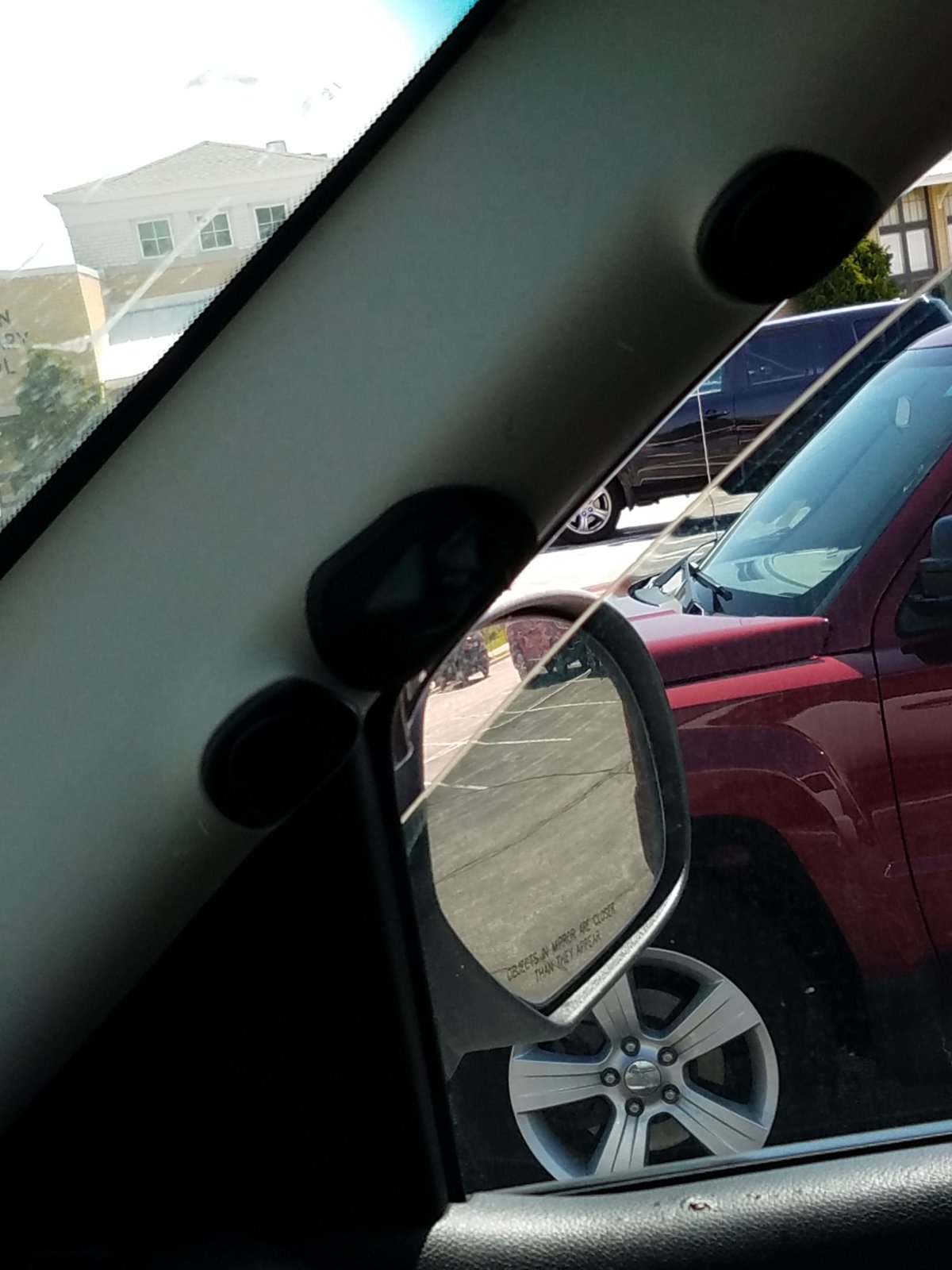

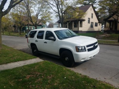

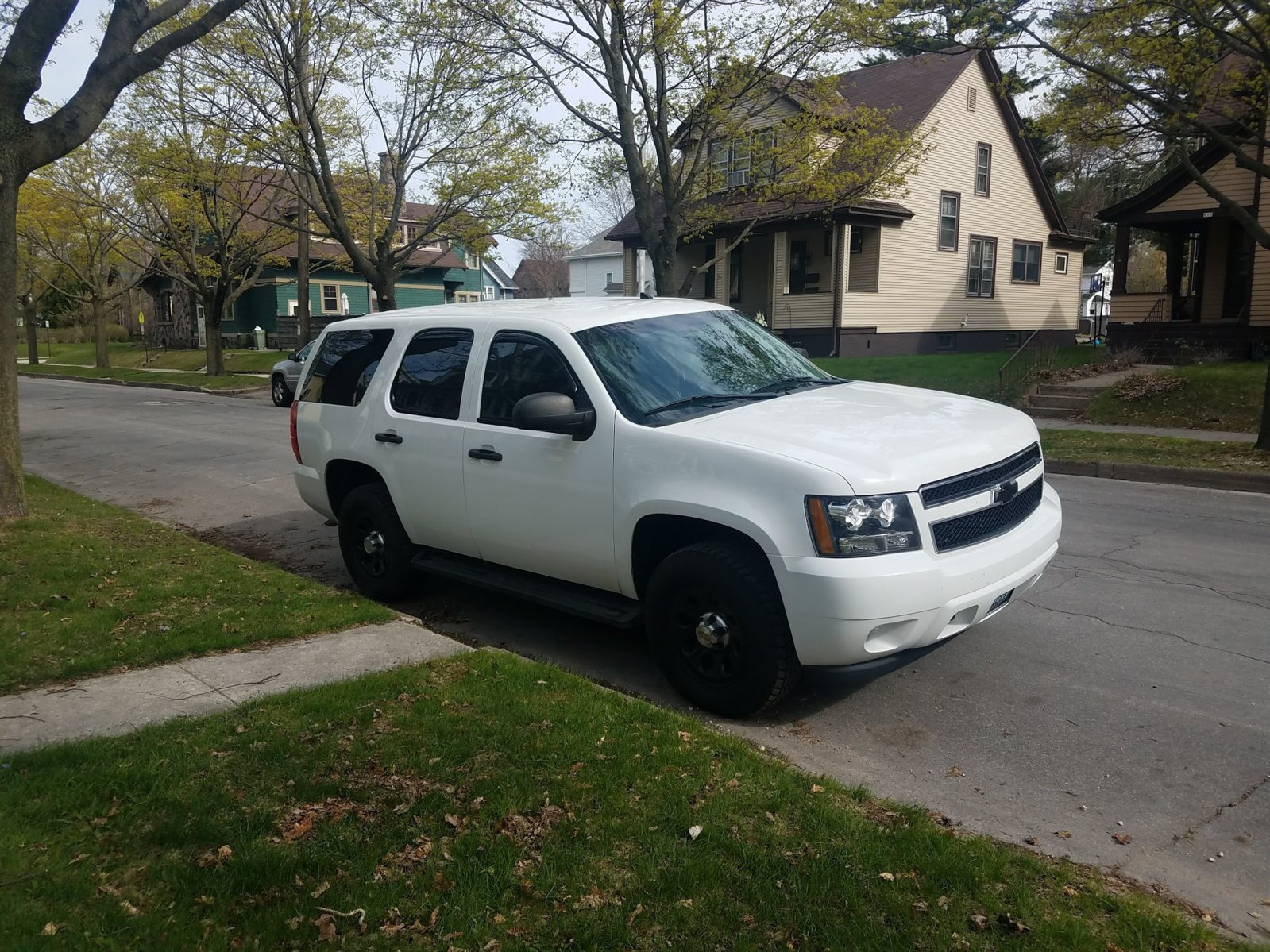

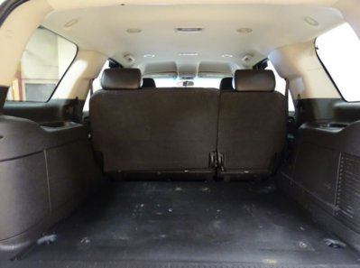

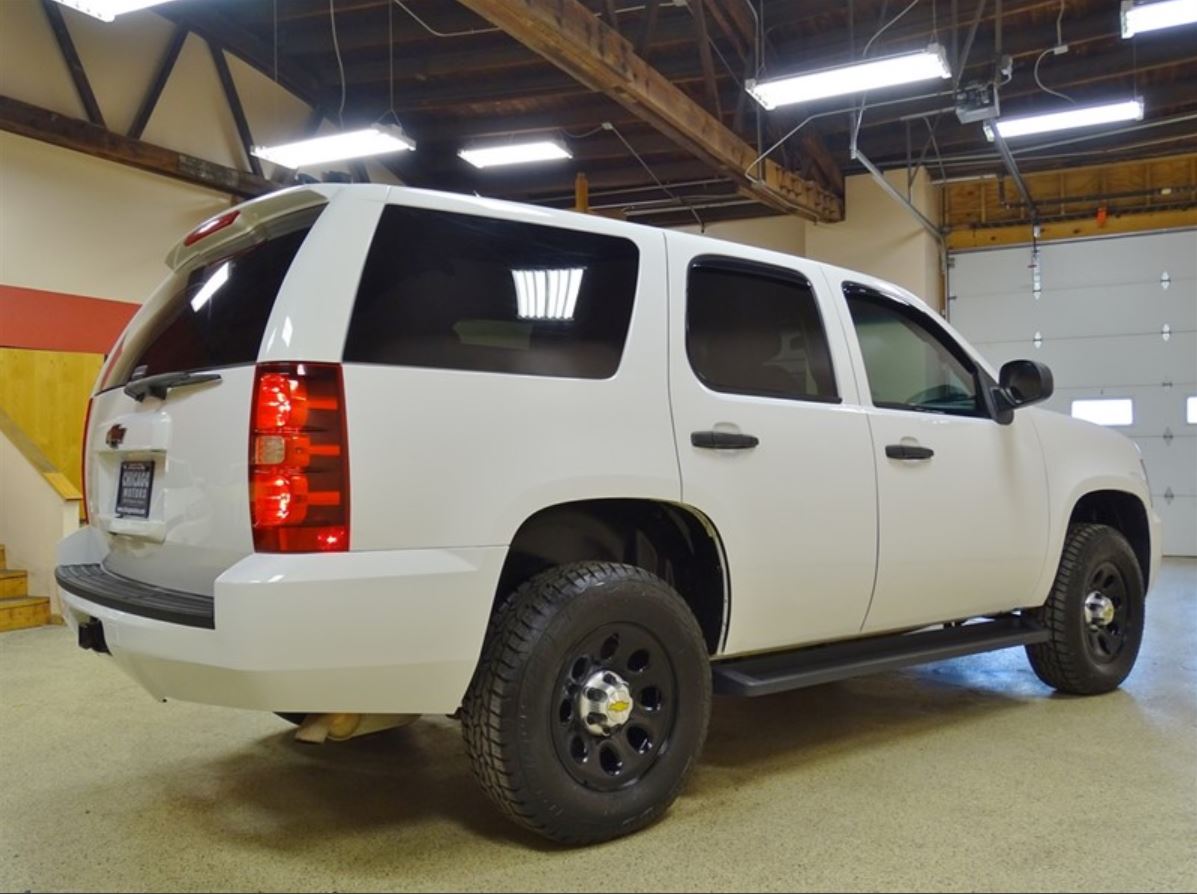

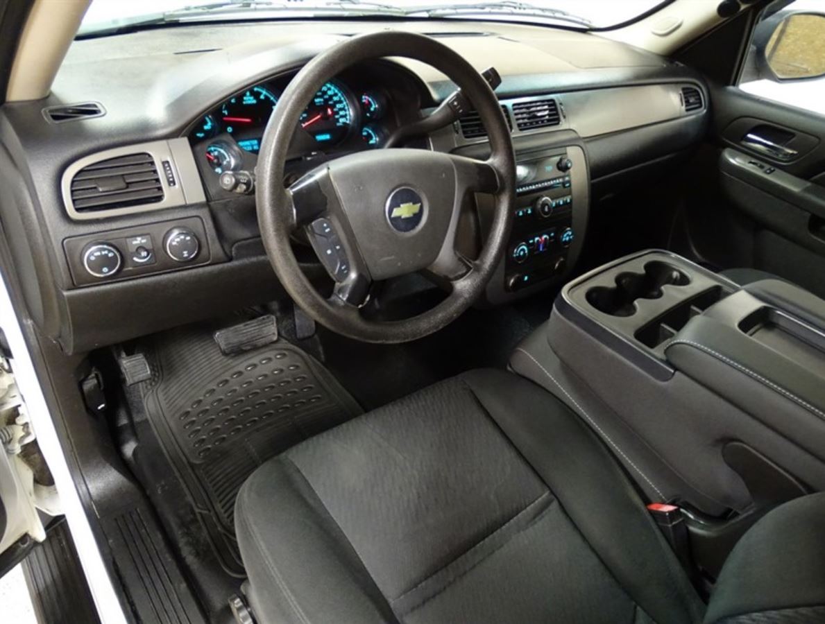

Hey guys, just bought my first Tahoe - 2010 Tahoe with 67k miles. From what I can tell, its a former border patrol truck from Laredo. I've done a bunch of searching for info on here since I'm new to this world, so I think I can say its not a PPV as it has 4wd. Tons of good info on here but I've noticed a few "quirks" after driving it for two weeks. Curious to hear some thoughts if I could trouble yall for some!
  • Fan Hi fuse looks like it has melted down and been taken out - scheduled the recall for next week

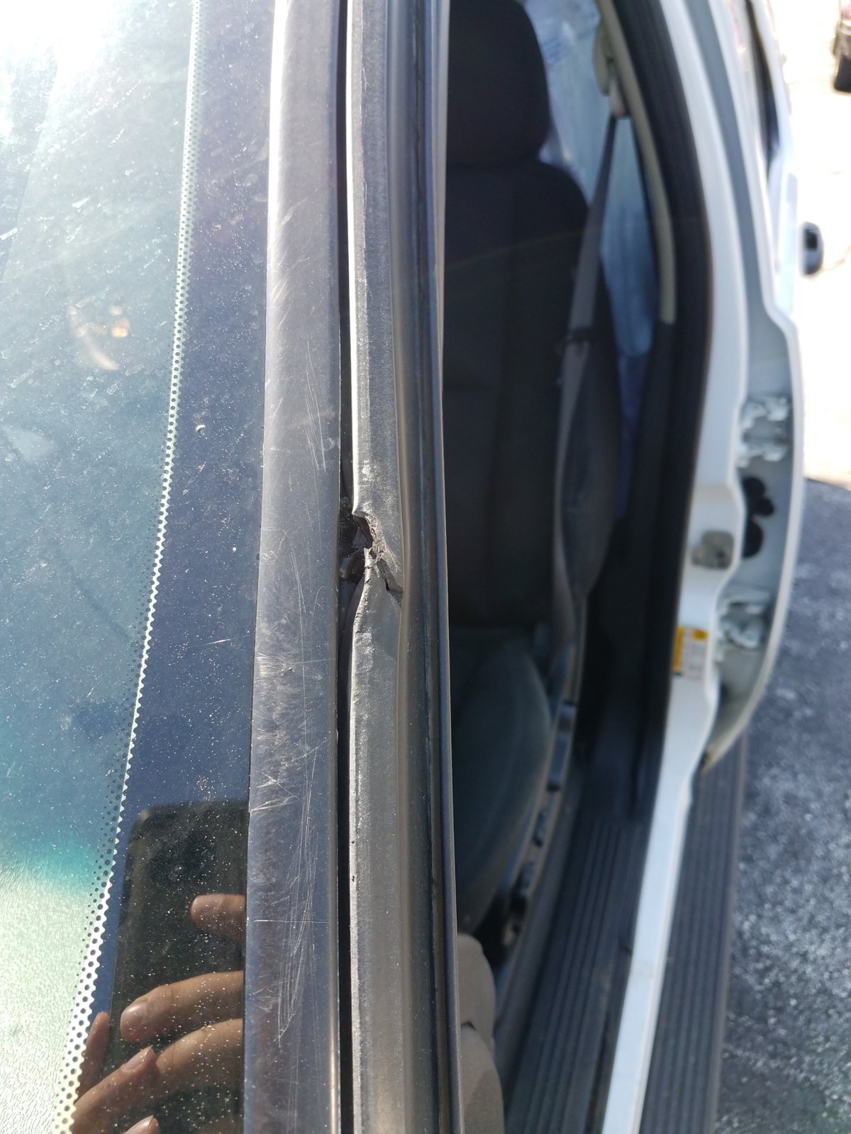

  • Sounds like air is coming in somewhere on the driver's side pillar, possibly where they took the spotlights out?
  • There is an absolute ton of extra wiring in the engine bay including for a dash solar panel - looks like thats normal from what I've seen on here.

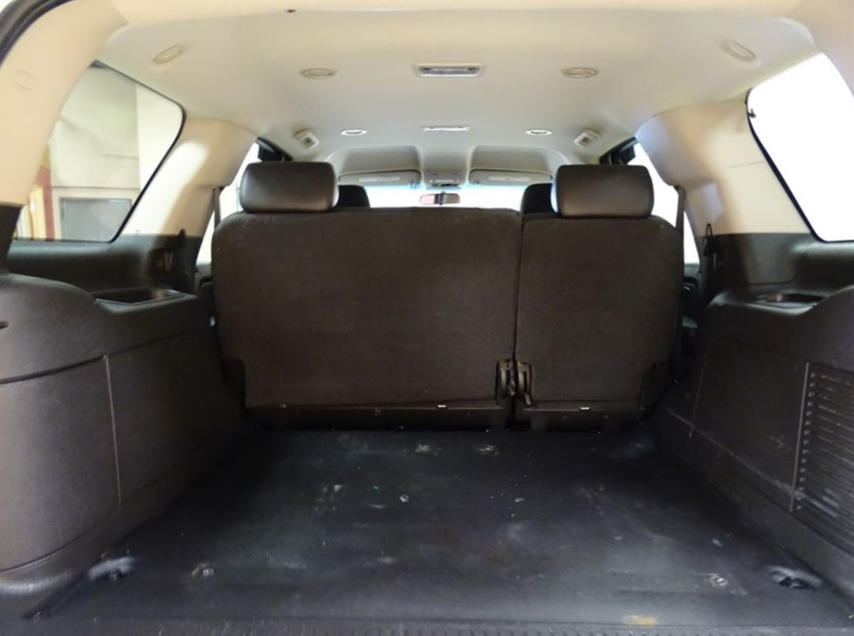

  • The rear seat has an issue staying locked in the up position
  • It's got a kind of "seatbelt" situation to latch the hood to the frame. maybe so it doesn't pop up while driving?
  • Interior is in very good shape I think. Very excited about the rubber floors and no holes in the dash anywhere.
  • "Service Tire Monitor System" comes on periodically, cant tell the rhyme or reason to that yet though.
  • Absolutely no rust since its coming from Texas, which is great since I live in Wisconsin - likely gonna get the underbody coated to prevent future rust.
  • Aux jack is loose, but I think that should be a quick fix.

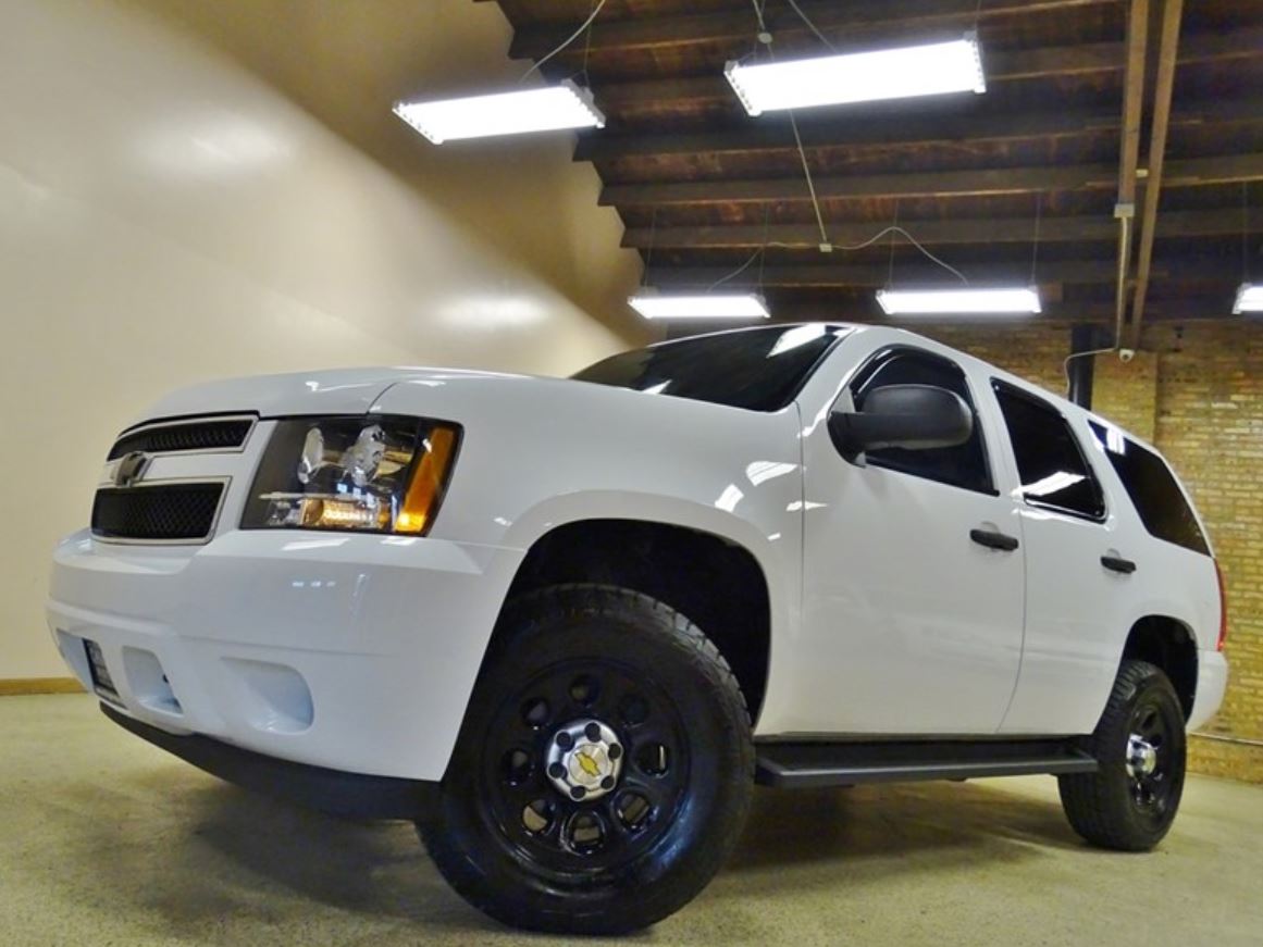

Nice Joe, Looks like somebody put PPV wheels on it cuz they are black, not silver.
Did you blackout the front bowtie, they are supposed to be gold, If you didn't, it probably did not come straight from the Govt agency Also I don't think Chicago motors removes the spotlights. Just my 2 cents

I haven't had time to do anything to it yet, as you see it in the pictures is how it came. I believe the sales rep told me they took them out, but thats not to say they didnt. Everything on my list of things to do are pretty minor so far, so I'm defintiely happy about that.

Benefits of an SSV (special service vehicle) much of the good stuff from ppv’s but with 4wd and less holes everywhere

I don't even see a spot light hole in the door...
Looks like they took the "oh shit" handle off the inside as well as the search lights.

That's a great looking hoe. Yes definitely get it sealed up and prepare for salt.

The bowtie on our '10 PPV looks black in some views. When my bride is coming down the street in it, I swear it's black, yet it's factory gold.

For the air leak, double-check the door seal along the A-pillar. If someone removed the spot light, I find they rarely replace the seal. There will be a cut in one of them. You can also pull the interior A-pillar trim and look for the hole there.
The rear seats in our '10 PPV sometimes takes some extra effort to get them to lock in place, even though they looked like they'd never even been sat on. Specifically what doesn't lock, the seat backs, or the seat bottoms?
