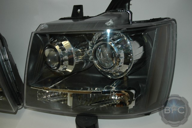

Hey, so Black Flame just sent me this link with pics of my retrofit. It should be delivered Friday and I'll install them over the weekend and put up some more pics. Thanks to this forum for directing me to find those guys, they were amazing to work with, kept me updated all along the way and it looks like they will be delivering exactly what I wanted, exactly when they said they would. Some of the best customer service I have ever dealt with... I totally recommend them if you are willing to spend the money on a retrofit. (lots of pics in link)

Can this be done with a NBS Tahoe?
yes. And you can do it yourself real easy.
Buy the depo projector headlights on ebay. http://www.ebay.com/itm/Depo-Pair-E...&fits=Model:Tahoe&hash=item4d14494259&vxp=mtr
Open them up, thow away projector.
Get mini morimoto H1 projectors http://blackflamecustoms.com/products/hid-projectors/morimoto-mh1-hid-projectors/
Get the 4500k bulbs and ballast and your good to go
A few people on here have done this... jdpber is one
here's a yukon, but the process is the same http://www.tahoeyukonforum.com/forum/showthread.php?t=43614
moe info
http://www.tahoeyukonforum.com/forum/showthread.php?t=37630
Just search retrofit in 00-06 exterior section

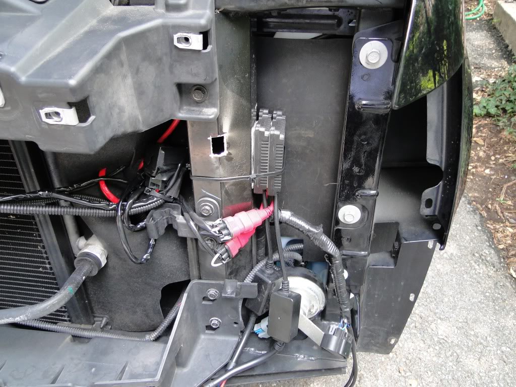

Looks sweet ... you've been informed that you'll have to drill a little hole in the vertical beams behind the inner projectors to make these fit?
I'm happy to post a pic for you if you need a visual to see how big.
AOK
AOK
Sep 30, 2013
38
Bozeman, MT
Thanks that would be great. Wasn't sure if it was plug and play or what, hadn't really asked lol. Figured they were easy to get in touch with so I would just call if I had problems. I appreciate the help
