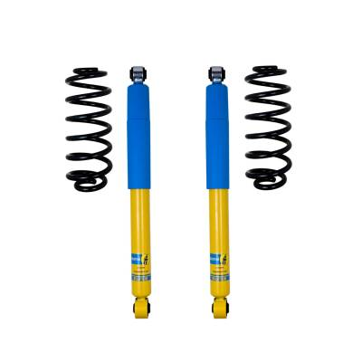

I have installed a Bilstein rear conversion kit (shocks and springs) on a '03 Escalade and an '04 Escalade ESV, and am 101% satisfied. Keep in mind It's a different kit for the Escalade and the ESV.
$300-ish from Rockauto and $300 for my local mechanic to install. Figure 1/2 day.

This is not where I got it, but it has a nice picture. This is for the ESV:
Rockauto is $300.79.

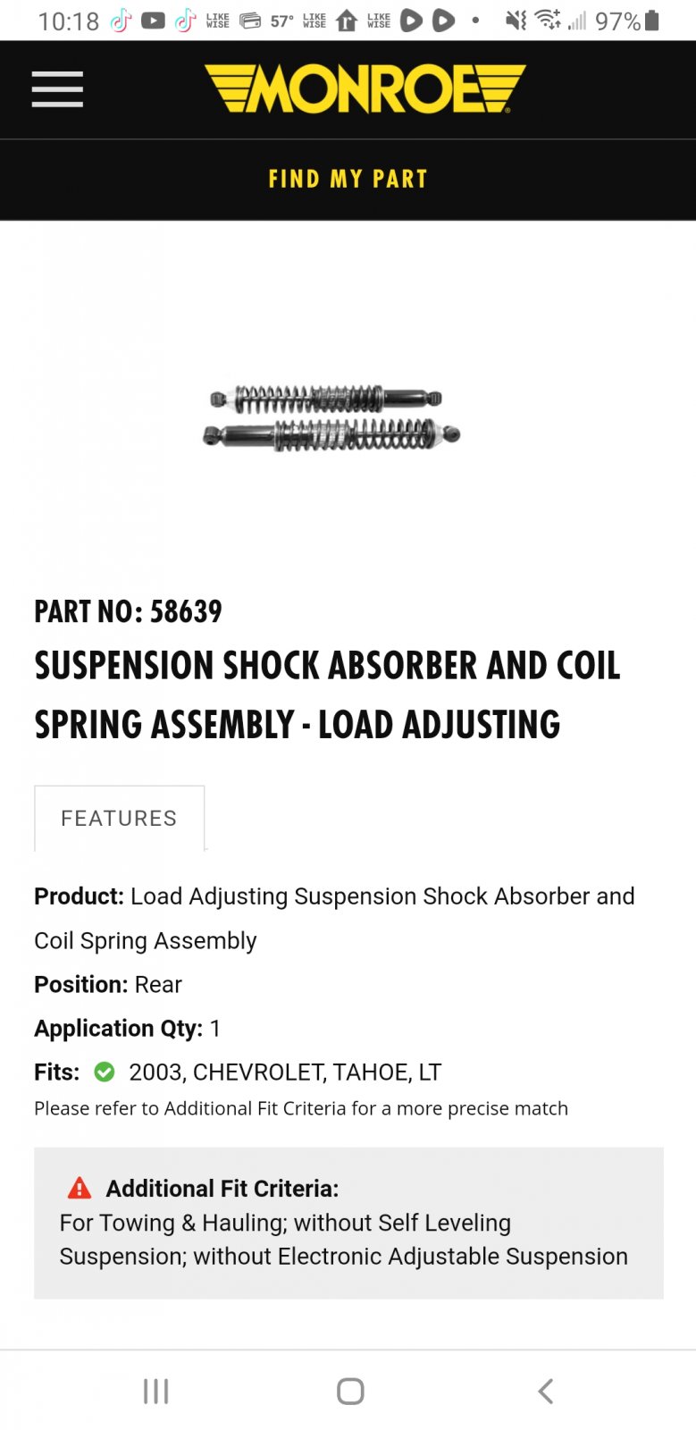

Looks like a nicely put together kit with plenty of info BUT, why is there no mention of who's springs those are? I personally would want to know.

Was doing some looking here earlier this week. I wonder if they would be Monroe like these.

If you all are talking to me, the Bilsteins I pictured is exactly the way they come. I love them . . . the stance and the ride. I loved them on our deer-totaled '03 Esc too.
I had our local mechanic install them, so don't know anything about that, other than the $300 and he didn't have any problem.
Our ESV is not a daily driver. We use it to drive from our Missouri place to our Florida place, with our dog and cats, and whatever we may be towing. We have daily drivers both places.

Which part number was for the Tahoe-length Escalade, and which was for the bubba-clade?You used Bilstein 4600 for the ESV? Is that it?
Sorry, I don't get notices of posts. 4600 is for the extended platform and the EXT/Avalanche. Just pay attention to the detailed description when ordering online.
