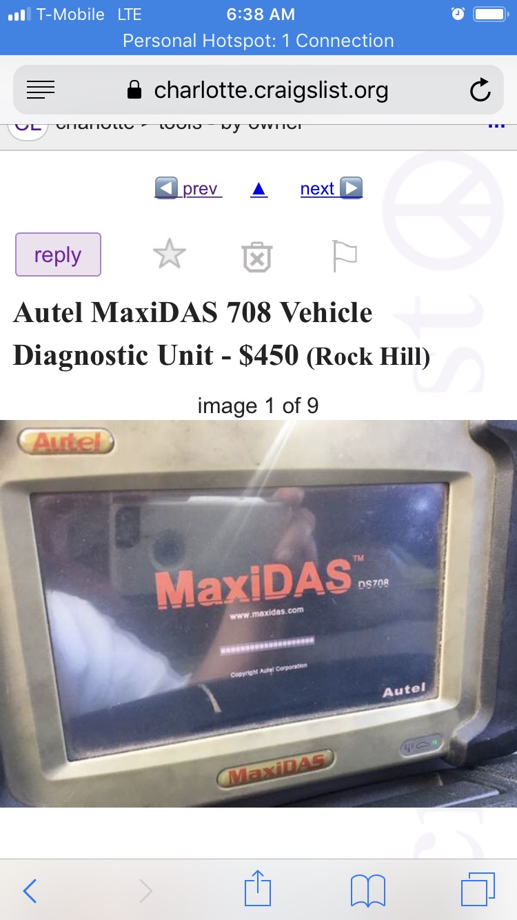

Check Craig’s list I see some really good deals on scanners.

But, to be certain, Wes, have you used the VXDiag Nano to do gauge sweeps ?
And David, do you own a DS708 ?

No just first one I found on Craig’s list in like 2 minutes. Many to choose from in my area. I have a Snap-on solus but would get a Autel or something besides a Snap-on next time. I was just saying really good scanners can be found used cheap.
