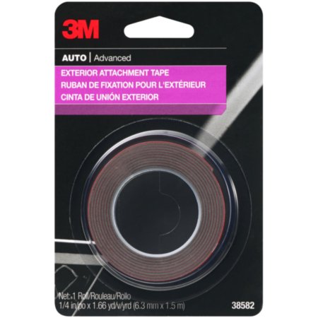

I have had good luck with 3M trim tape.

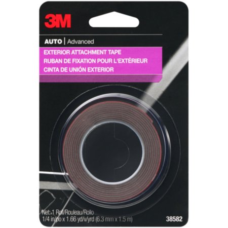

One of the 3m molding tapes, like this one:
Many other choices of strength and permanency. I think I've used the 03609 Super Strength before. Good stuff.

I would get about the same width as the molding, maybe a little smaller. Or buy larger and trim down. The "036xx" series is the Super Strength.
https://www.amazon.com/3M-03609-Sco...words=3609&qid=1606357292&s=automotive&sr=1-9
Not sure if that's appropriate for glass. It's gray in color. On windows I've had issues with dark colored velcro (toll road transponders) soaking up the heat of the sun and the adhesive releasing.

That high strength 3m tape that wade and steve mentioned are great. It’s holding the the wing on my trunk of my black accord... no issues.
