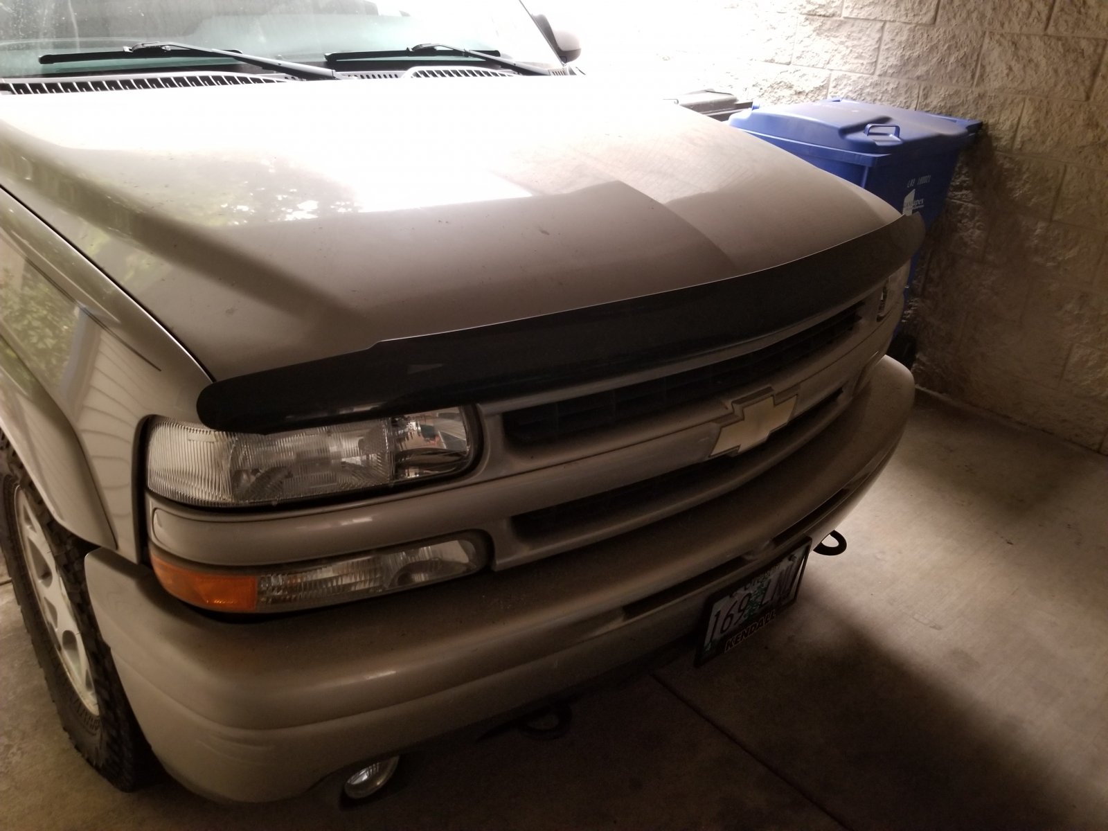

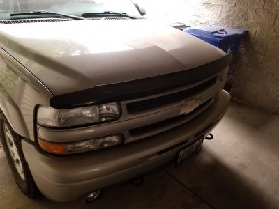

Some idiot but these air deflectors on all 4 doors. Gotta get them off and clean off the sticky crap. Recommendations for the process. Have never had to remove these before. Thanks in advance.
Excuse the filth but this is parked at the back of my car port here where I live and work and my 02 Tahoe is parked in front of it. The back is exposed to the outside and the fires here in Oregon have created lots of ash. This is after I have blown it off with air each day. Can't wait to give it a great bath this Monday.
Never mind the pic of the one attached to front of hood, I know it attaches with screws.
I tried to remove the pic but all it did was move to bottom and made the pic smaller.

The bug deflector is likely just screwed to the underside of the hood., 5 screws. Mine looked (past tense...) the same and was easy to remove.
Yea, I just edited my post about the hood one. I know it attaches with screws. Thanks. I tried to delete the pic but it just moved to the bottom and made pic smaller so I explained that too in my edit.
