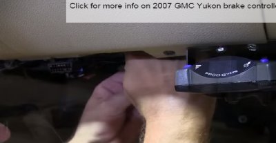

I just purchased and wired a Prodigy 3 brake controller on my 2008 Yukon XL Denali.
I'm just curious where everyone is mounting their units. It seems like my right shin will always be hitting it. I'm 6'2". I have yet to drill any holes.
The picture below is what I see most online. Just want to install in an accessible location that is out of the way of my limbs.
992dr
Oct 8, 2009
3,287
1,355
Eastern N.C.
I had mine mounted like that but I centered it under the dash.
My center console didn't go up and under my dash so I had the space.
It was out of the way but close enough to access if I needed to do any adjusting.

mounted my P3 in that same place. also secured it with the screws that came with it. but i didn't drill into the lower cover. i used a screw that was already there

I've also seen brake controllers higher up on the lower knee bolster kick panel below the instrument cluster. Don't want to make permanent holes in my dash though.
I may position in the center bottom of the kick panel and see if that helps. Would prefer to secure with screws over velco.

That's where I mounted the controller on our '02 Sierra. Like aflumb, I used existing fasteners. I'm not tall, but do sit pretty close to the wheel. I've hit the dome light switch with my knee, but have yet to hit the controller at all. We've had the controller since 2002, with no issues. It's also a Prodigy.

I mounted mine using the one existing screw just to left of where the mount is located in the picture above. No use drilling if I don't need to.
I don't even come close to having my leg hit the brake controller unit when it is attached to the mount.

Dunno if anyone is still following this but I mounted my Prodigy today by cutting through the plastic panel under the steering wheel. I reached under the bottom edge near the center console and marked above the steel dash panel and cut it out to fit. It isn't great but it won't hit my leg any more.

Yeah or high density black foam. So far it's just a snug fit and a little tape keeping it in place. When I cut the knee panel I used the metal behind to bend around for support instead of cutting it all away. I need to attach a couple of ears to screw the sides in place probably from the back side of the panel. Right now I have a little interference with the metal support hoop below the steering column that's keeping the angle off just a little. I guess I should take pictures and post.
When I drew out the hole I wanted I was thinking of mounting the click in bracket so I could pull it out. As I cut it out I realized I could mount it without that so the hole didn't need to be quite as large. I figure these panels are plentiful in junk yards and no other parts of the vehicle need to be modified for this.
