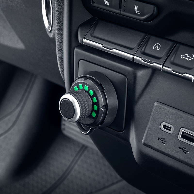

When I was doing the research on whether or not to buy a MAX Tow package Yukon I spent a lot of time researching this. Everything I read said you couldn't add the factory controller because that controller is integrated via software into the dash so you can see the trailer gain, etc on the dashboard and without that software you would have no idea what your gain control was set at. I was told you needed an aftermarket controller that mounts near the radio similar to the one pictured below. This one is offered on the GM website for adding on a brake controller. I'd call the a dealer and see what they say, but based on the month+ of research I did, the controller you have will not function properly. Aftermarket brake controllers should be plug and play like this one but are not integrated into the DIC which is where the factory brake controller is going to have problems without the software.

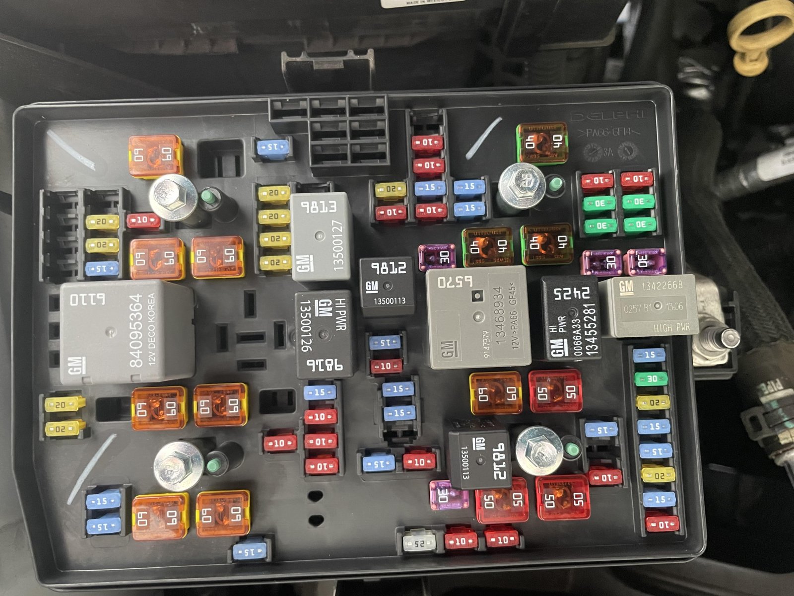

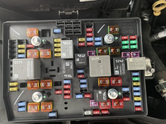

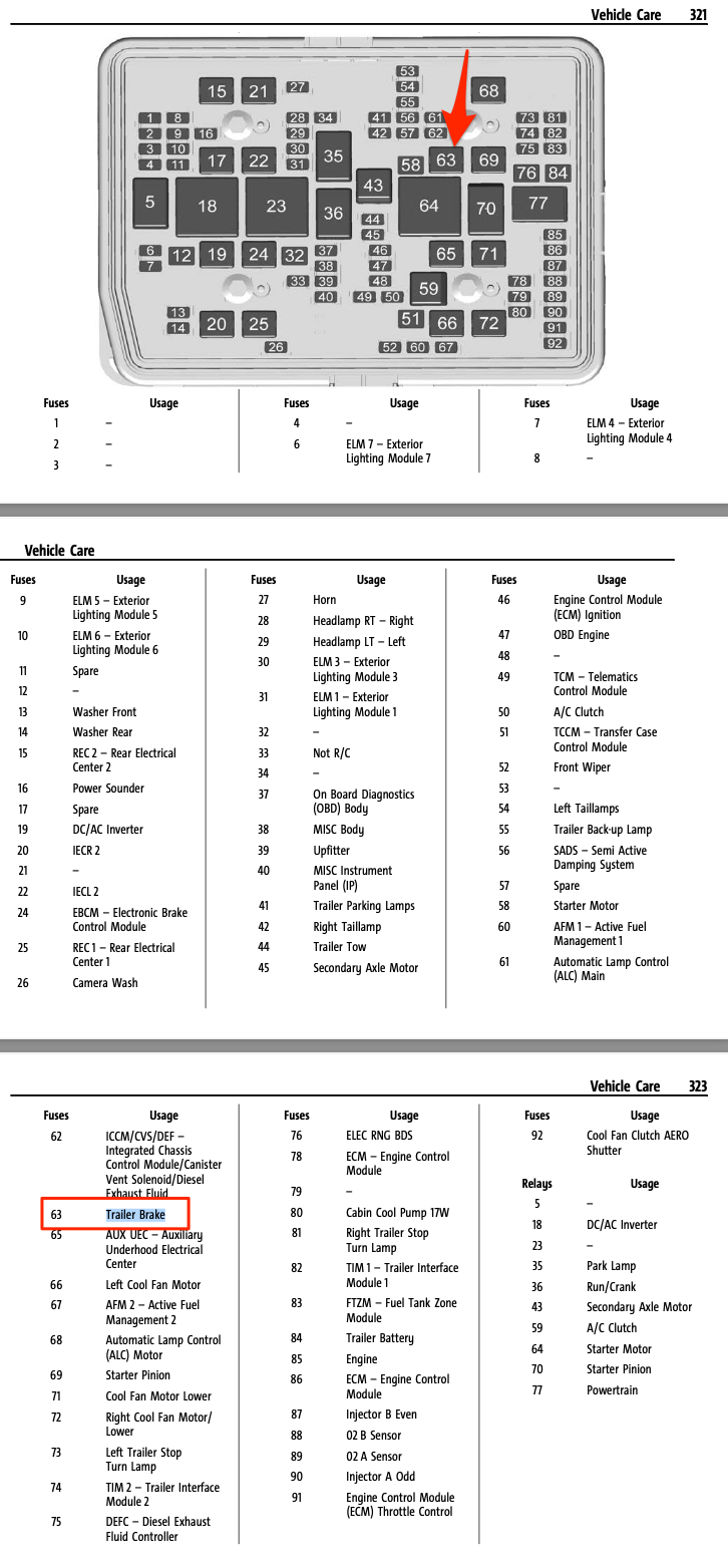

May need a fuse installed? Possibly a reprogram? Not sure..check to see if fuse 63 in the underhood fuse block is installed:
