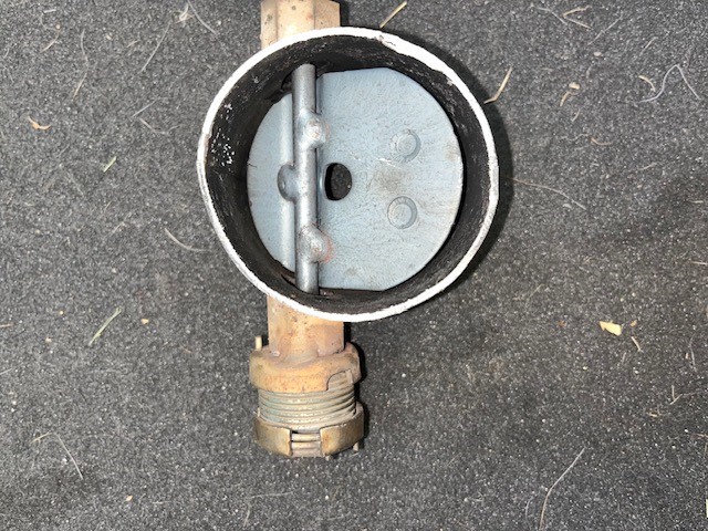

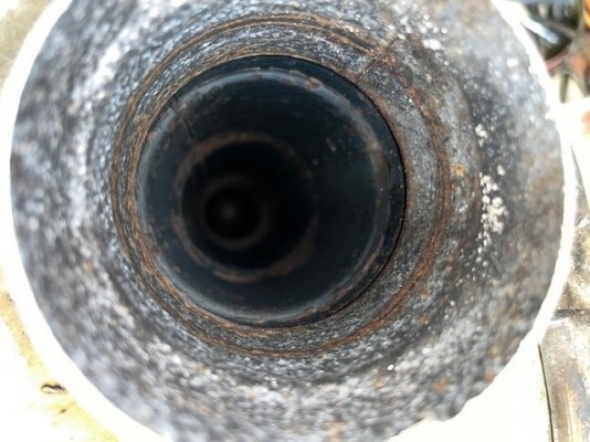

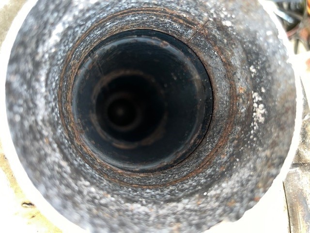

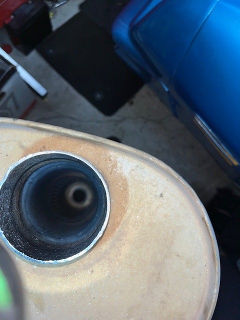

I have the Range module installed on my 2021 HC Suburban and so far I like it. I also installed a Walker Dyno Max muffler 17789, 30 inches long and 3" all the way through. I cut the old muffler out and welded in the new one. I also removed the valve in front of the muffler. It has a pleasnat tone at idle, just a little louder than the stock "dual" exhaust and it sounds good driving. I used this same muffler on other Suburbans before and have been happy with it. I typically have seen a mile or two improvement on the freeway. I was surprised about the valve and how the stock muffler necked down inside it.
