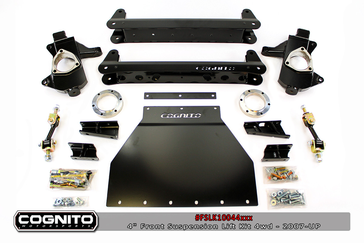

http://www.cognitomotorsports.com/fslk10044xxx.html

Like others have said I'd say cognito. Had one on my silverado before I did the SAS and would have loved one for the tahoe but got the procomp for a killer deal. Next I'd go with FTS but that's just personal preference.

The cognito doesn't seem to come with anything to extend my strut.

I thought it was odd that it uses the factory strut with no spacer or what not. But it would be the perfect time to upgrade it to a aftermarket strut like bilstein or go with a coil over option
