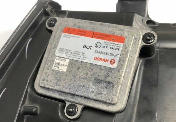

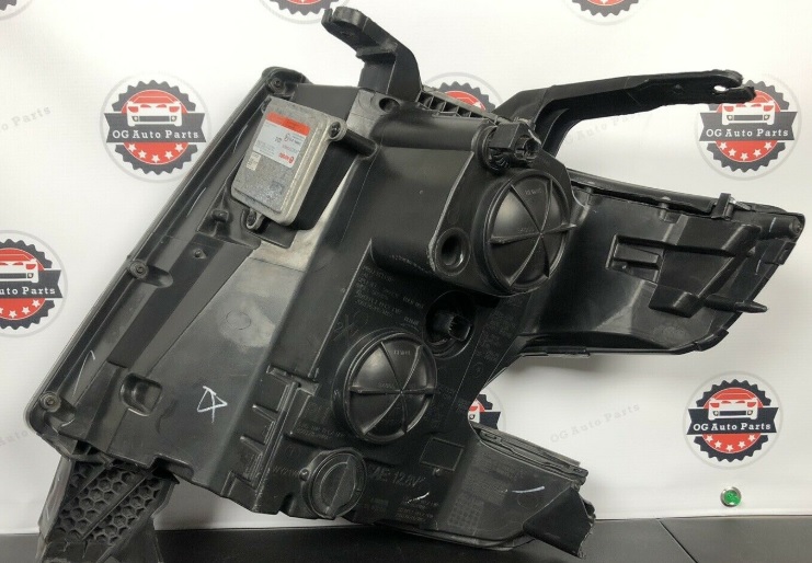

What color are your headlights? yellowish or white?
Do your headlights have the silver ballast on the side?
