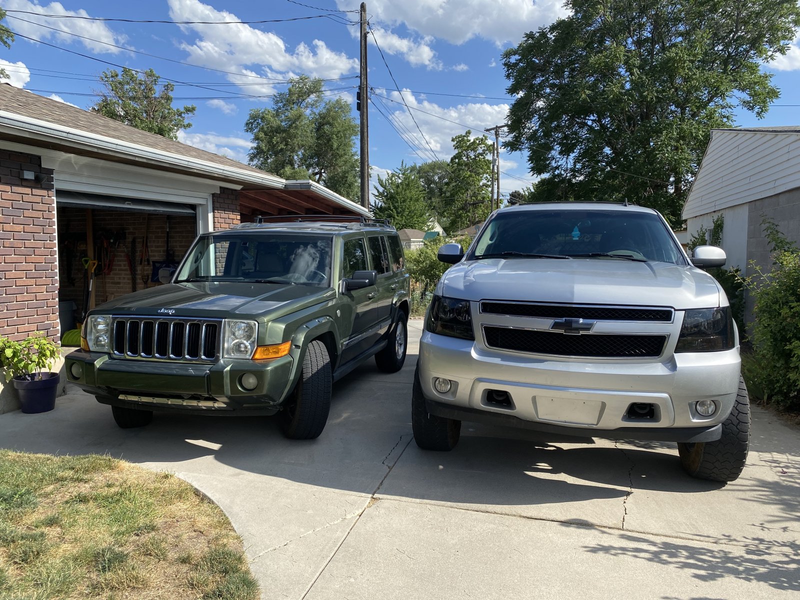

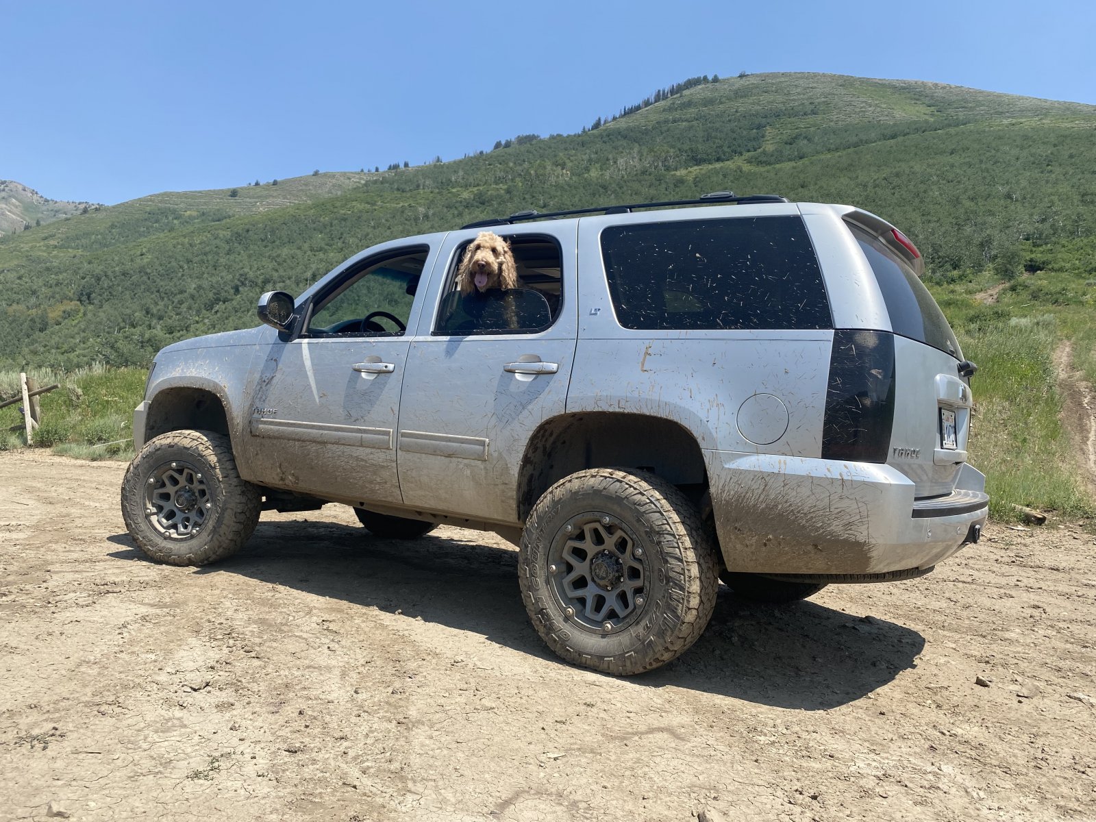

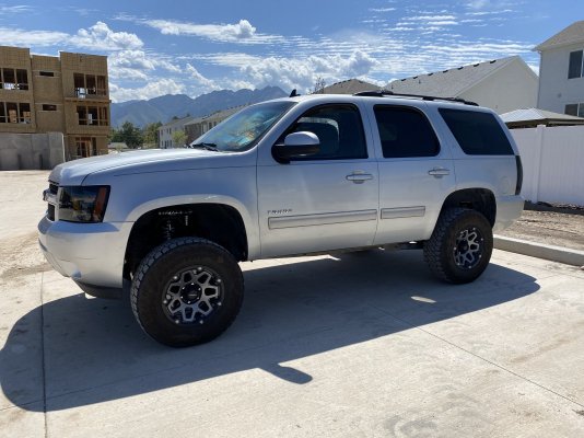

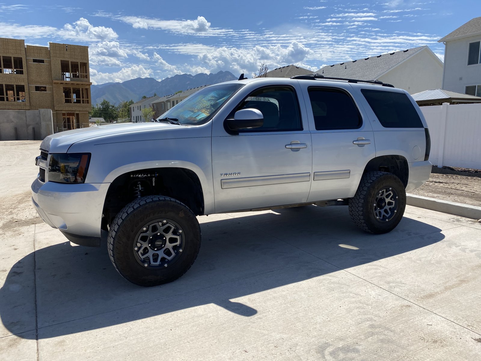

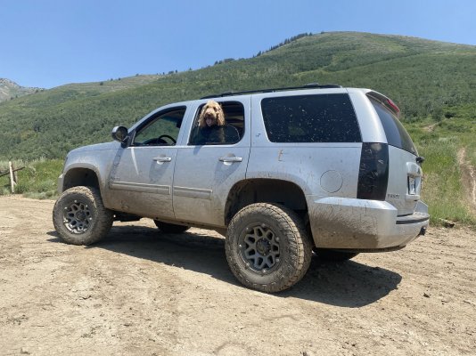

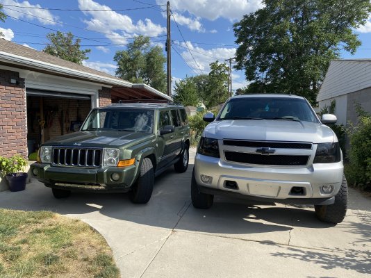

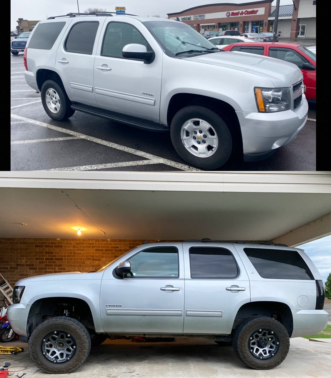

I ordered the 4” kit with Fox 2.5 dsc coilovers in March and it took almost 4 months to get it. But damn was it worth it! I did the majority of the work myself with assistance from 2 different friends. It took 3 days being an OK driveway mechanic. The ride quality is amazing and the clearance is higher than I expected.

@gnarlyallen your rig looks great! It is taller than I would have expected for a 4"! Any settling since then!

Ditto what size wheels and tires did you use with that 4.5 lift? It's hard to tell in the pictures does the rear sit lower than the front?

Sorry for the slow reply. My company has me working 6 days a week.
Anyhow, the wheels are a 17x9 with a 12mm offset. BDS recommends a 0 offset, but I really like the look of just a little negative offset. Because of that though, I’m rubbing in my wheel wells on the front and I’m going to have to take a grinder to a couple of small places. Oh and they are Vision Se7en wheels. They weren’t available anywhere, but I found them on eBay for $680 for the whole set!! They are my favorite part of the build, next to the Fox remote reservoirs. My tires are a 285/75/17. They are some used Toyo Open Country CT’s, which are technically a commercial tire.
I measured the height the weekend the lift was done and it is 2” higher in the front. I guess that is the “prerunner look” they advertise. If I could reorder it, I’d opt for the extra inch of lift in the rear that was an option. It may have settled a little with the Fox Shox breaking in… I’ll have to re-measure. I’m torn on my thoughts on the “lean.” In the future, I’ll probably lift the rear another inch or two and maybe add some airbags, as I may buy a camper next Spring. And that way I can add onboard air too, for off-roading and general badassery.
I can say that the Tahoe handling is extremely tight (much better than before) and the shocks are soooo plush!! It’s like it had a baby with Grandmas Caddy. And that extends to off-road as well. I had a 2012 Ford Raptor in the past, and this suspension is seriously on that level as far as feel/responsiveness. As a side note, I’m going replace my upper A Arms before too long with a uniball. Maybe Camburg, or even BDS makes some. But with the uniball, you get more useable travel and aftermarket A Arms will handle more abuse, because I know how I drive off-road. Lol
One last thing- Did you order the 4” or 6” lift?? I wanted the 6”, but I have to lift tools and dogs in and out every day.

I ordered the 4" coil over kit with VSC
